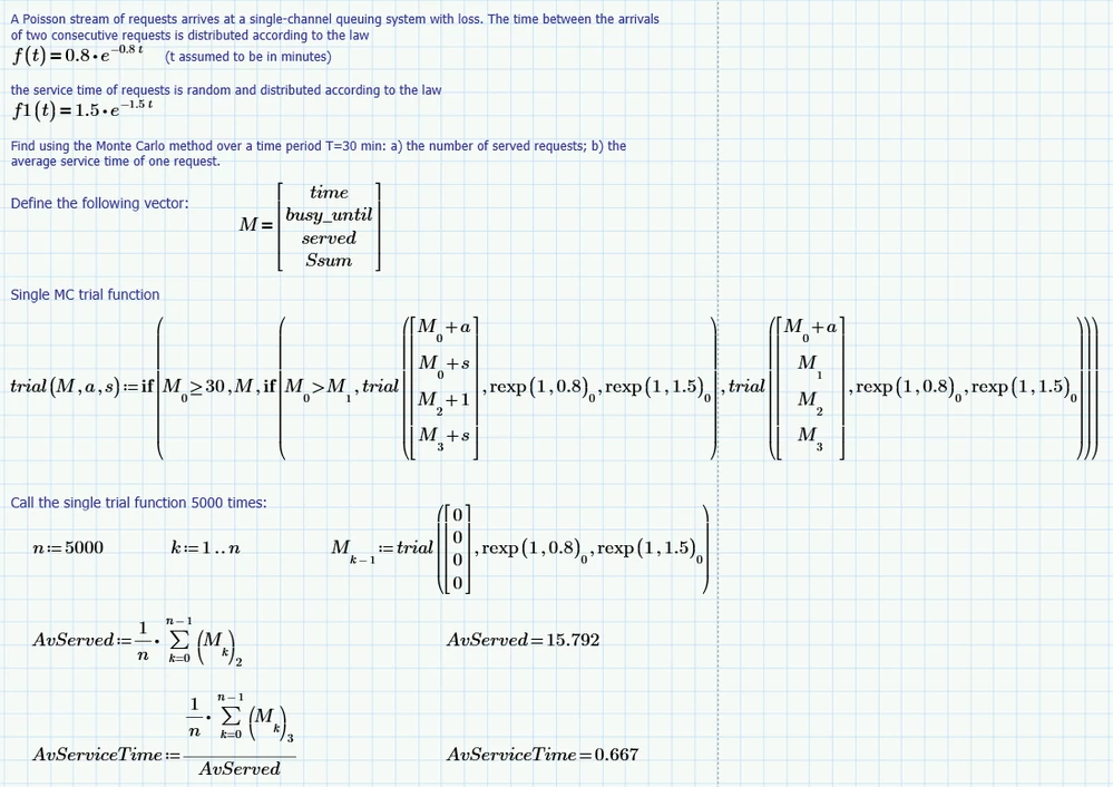

Solve the problem using the Monte Carlo method
"Problem. A Poisson stream of requests arrives at a single-channel queuing system with loss. The time between the arrivals of two consecutive requests is distributed according to the law
the service time of requests is random and distributed according to the law
Find using the Monte Carlo method over a time period T=30 min: a) the number of served requests; b) the average service time of one request."
If possible, please provide screenshots of the solution to the problem using Mathcad so that I can understand and clarify the essence of the solution..

Nov 27, 2025 1:25 PM UTC
See enclosed file.
Screenshots are extra 🙂
Werner_E25-Diamond IAnswer
Nov 27, 2025 7:19 PM UTC
I hesitated to do the OP's homework before he showed a little initiative himself.
But okay, the dance has begun, so here are my two cents. A screenshot was asked for, right? 😉

Dec 1, 2025 3:59 PM UTC
I thought I'd have a go at this using Prime Express.  The result can be seen below.  Although the method seems quite clever, it's as clear as mud!  My mantra was always, "clear is better than clever".  Seems I'm forced to forgo that now I only have Express!
Alan
