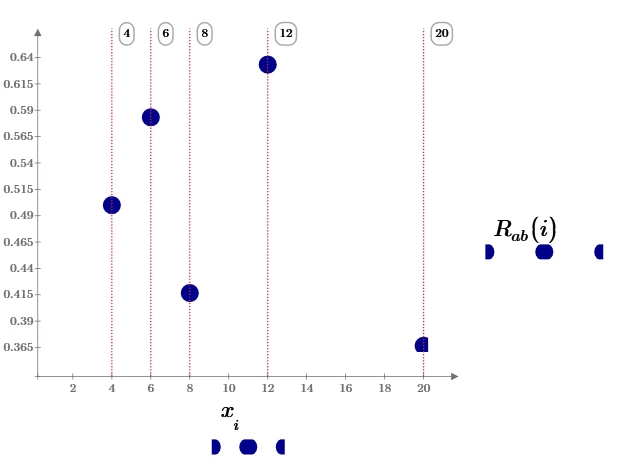

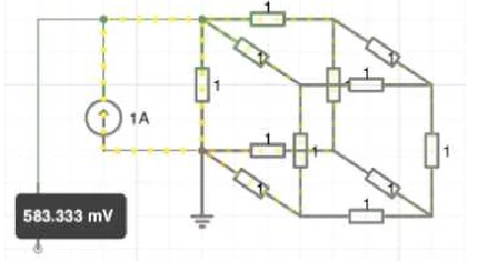

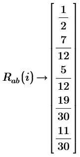

Solve the resistance of one resistor of regular polyhedron 3D mesh.
R(4)=1/2, R(6)=7/12. How about R(8), R(12) and R(20)?
ttokoro
ttokoroAnswer
March 24, 2020
Resistance of one resistor branch by Mathcad.

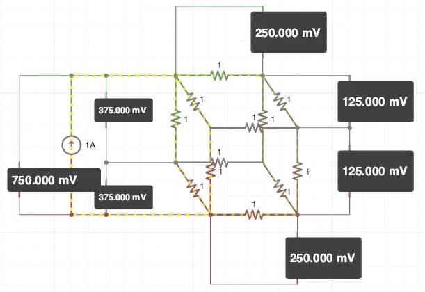

Thanks. Your case is a diagonal resistance of regular polyhedron surface.
Regular hexahedron shows 3/4 ohm. I am using current generator of 1 A.
So V=IR =R shows the resistance itself.

ttokoro
ttokoro21-Topaz IAuthorAnswer
March 24, 2020
t.t.
