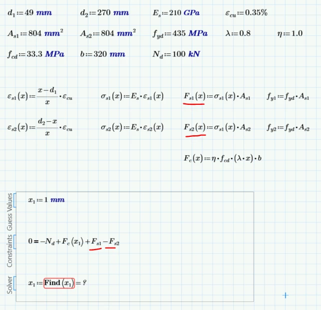

Hi
I have set up a function, where I want to find the root x.
I have made an attempt in the attached file to use the Solve block-function, unfortunately I get an error message and don't know how to proceed.
If somebody could help me, I would be really thankful. 🙂
CornelAnswer
Jun 8, 2023 1:57 PM UTC

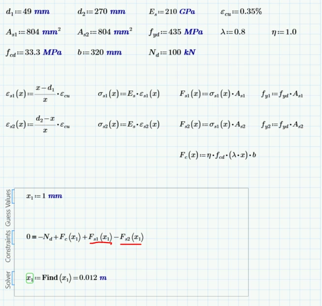

From what I can see, Fs1 and Fs2 are defined as functions in your file (they depend on variable x).
Cornel19-TanzaniteAnswer
Jun 8, 2023 2:05 PM UTC
Thanks! 🙂

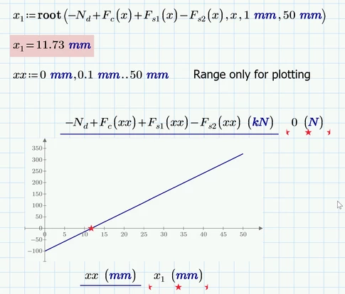

You may also use the "root" function to get your solution
Jun 9, 2023 5:24 AM UTC
Great input, thanks!
