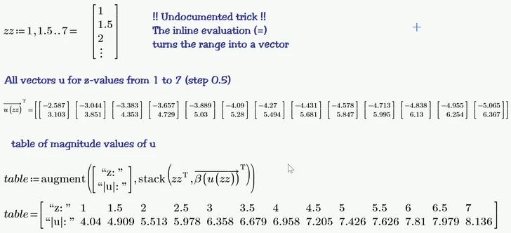

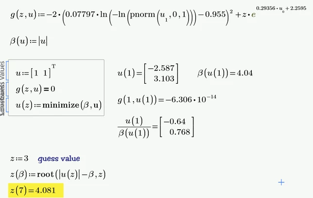

I've just got an assignment in school, where I've to determine the design factor 'z' to a given failure probability.
This baisically means that I have to find the lowest value of beta (vector containing of u values) that in combination with design parameter z gives an failure function which is equal to zero.
Want to make a loop which can check for all values of z in the interval of 1 and 7. Is that possible?

You can turn the solve block into a function u(z).
Then you can calculate the vector u for any value of z.
A second solve block with "find" or the "root" function (less space consuming and less ugly looking) then could be used to find a solution z of the equation u(z)-beta=0. No need for the for-loop you suggested - let Primes algorithms do the iteration work.
