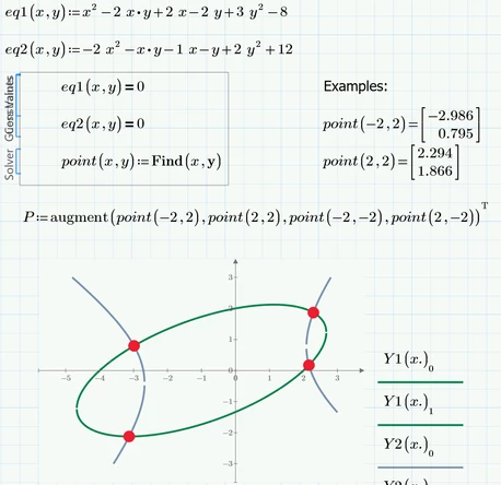

Hi everyone. I'm very new to MathCAD, using Prime 4.0. I was able to figure out solving 2 simultaneous equations using Solve blocks, and now I'd like to take that one step further so I could solve for multiple pairs of input values. That is, I already have a solve block that finds correct values w/ guess values x1 & y1, and would like one that will solve for x1 & y1, x2 & y2, x3 & y3... I'm guessing this would require some sort of matrix magic, but I'm not really sure. Obviously, I could just copy & paste the solve block for each new pair of inputs, but I have to believe there's a more elegant solution. Can anyone provide some advice?

With input values you obviously mean the guess values, right?
You can turn the solve block into a function with the guess values as arguments.
Just attach your worksheet with the example solve block which you expect to return different results for different guess values.
June 22, 2019
Here is an example of what I was talking about:
Worksheet in format P4 attached
June 23, 2019
This looks like a very clear example!  I'll try to implement it in my sheet, and share the results.  Thanks Werner_E!
