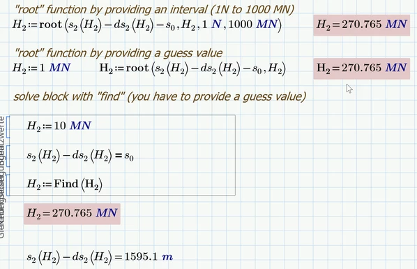

But in case s_0 is known (as to seem to be the is the case in your PDF)
you could  define functions as explained by Luc
and use them either with the "root" function or in a solve block with "find":

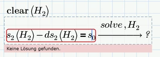

BTW, I would not recommend using the symbolic “solve” facility if the only goal is to find a numerical solution. In this specific case, it could also fail due to the integral.
EDIT: Gave it a try, and  - yes - "no solution found":

BTW, instead of a solve block with "find" you can also use the "root" function in one of its two flavors.

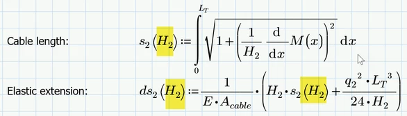

You need to correct one error:  There's a q_2 in one expression which probably should be a q2.
You should refrain from evaluating definitions. That is: remove the  =  at the end of the definitions of s2 and ds2.
You should write s2 and ds2 as functions of H2, so you get:
and
And bear in mind that s2 also appears in the definition of ds2, so there it is also a function of H2.
Then finally you can solve:
s0 - s2(H2) - ds2(H2)
as the function to solve for H2 in the root(), for any value of s0.
Or you could (try to) symbolically solve H2 as a function of s0.:
(Make sure that you type a bold equals for this equation.)
