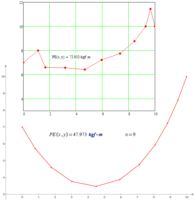

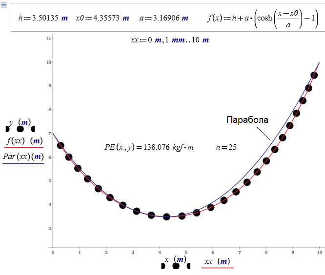

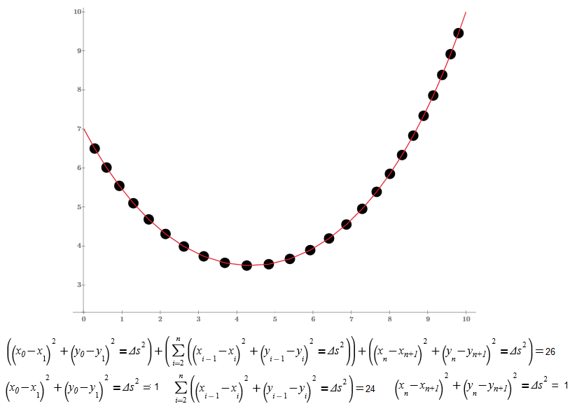

n=25! What is the max n for Knitro ? Work please with attach!
Verify for n=25 masses

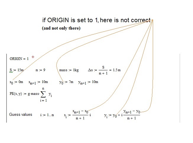

Why, then, let pass variables with subscript, for elements of a vector?
Sorry, but all is OK!
x0, y0, xn+1 and yn+1 are x.0, y.0, x.n+1 and y.n+1 not x[0, y[0, x[n+1 and y[n+1

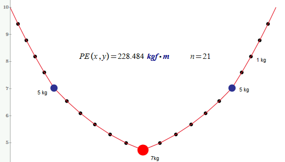

Hi. Attached seems to work fine when masses are uniformly distributed, but I'm not convinced enough when the chains are varying.
Best regards.
Alvaro.

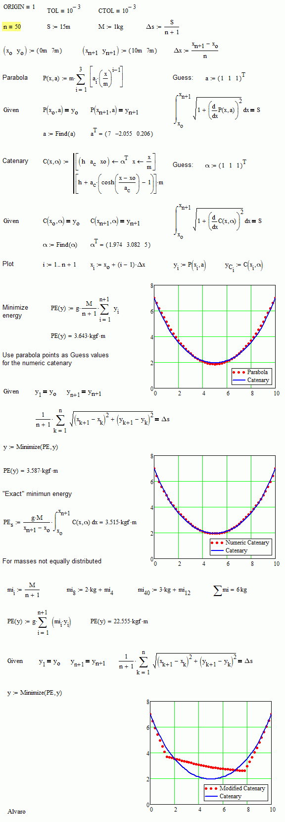

Hi Valery.
Some other few modifications. It's a hard problem, have a lot of variations. Can't found my Elgotz to check what he says about this variational calculus.
Best regards.
Alvaro.

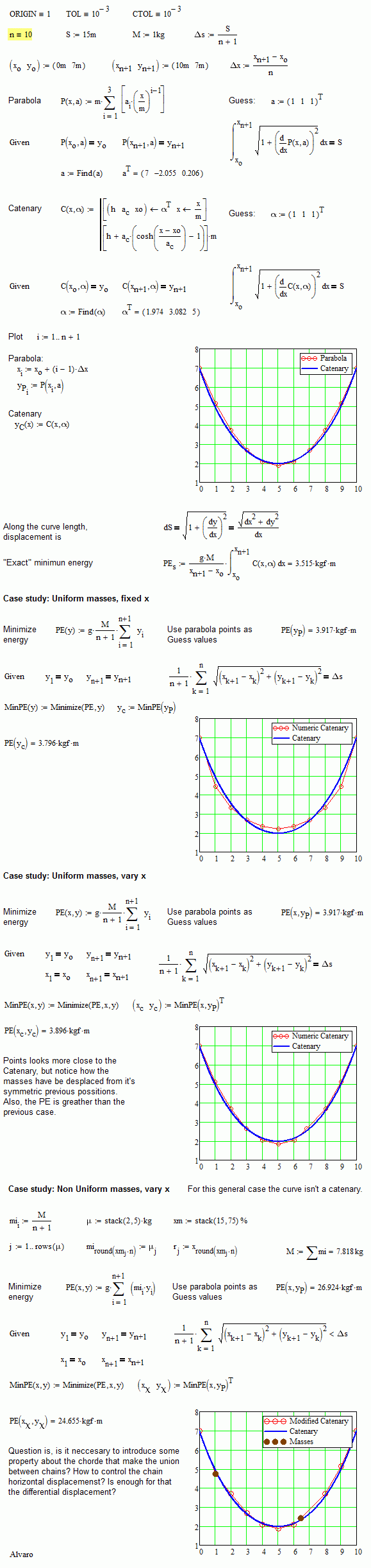

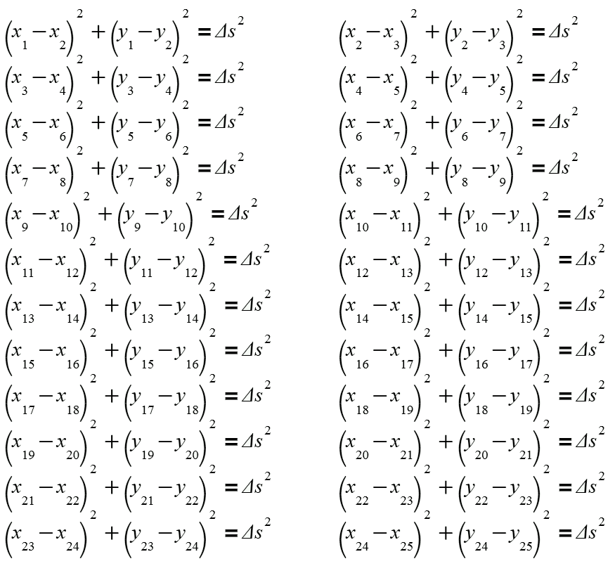

The problem is so.
I have in the Solver
but I want to have so
But it is not possible in Mathcad 15 and Prime.
Yep, I know.
In the attached, instead of the summatorie, which give scalar result, in the solve block there are vectorial restrictions, introducing a Delta function, which is the diff function in matlab. So, you have in some way what you ask: a lot of equations in the solve block, but without writing them one by one.
Notice that the poor results, reflected in the Potential Energy values, are problem of the Mathcad solver, maybe in prime, with the knitro solver can get better results.
Also shows that in a Given-Find block, you can use range variables, but with some limitations. At the end an example of that.
Best regards.
Alvaro.
