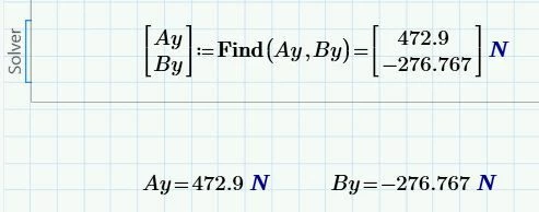

For a project (designing a log splitter) at school I am now working with Mathcad for the first time. However, I am now running into some problems. Maybe it's something really silly but I can't manage to solve two unknown variables from two equations. On the internet it is done with the find() function, but for me it doesn't work. Each time the 'find' function will output the follow: Find(Ay, By) --> Find(Ay, By) where Ay and By are the unknown values.
If anyone knows how to do this, please let me know.

Enclosed is solution. Problem with units solved.
Cheers
Terry
April 19, 2021
Cheers
Terry
April 19, 2021
Did not show how to return values from the solve block for use later in worksheet.
