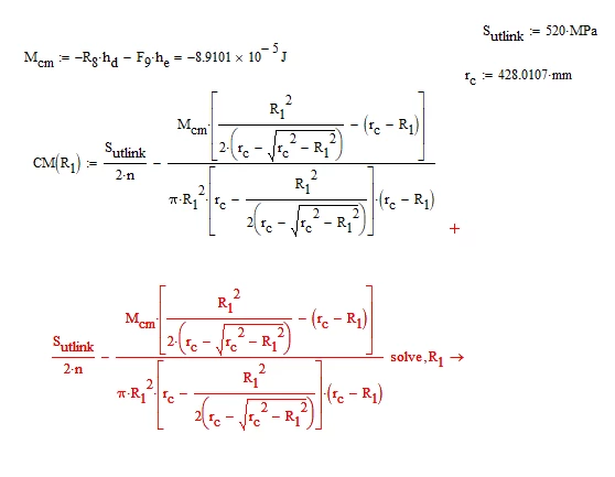

Can anyone help me solve this equation? I tried everything but couldn't manage it. mathcad.PNG

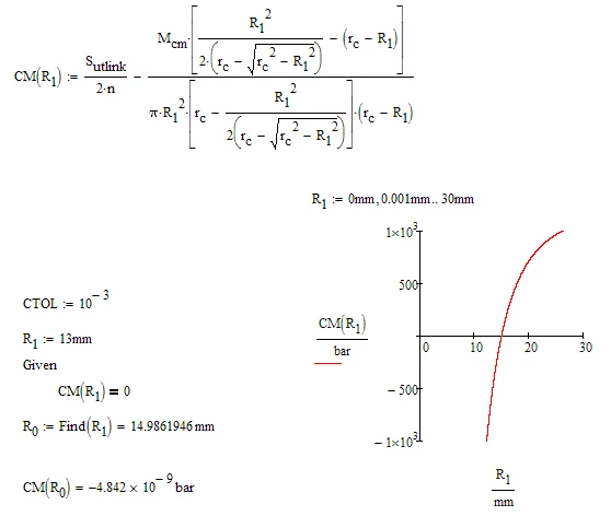

Why not use a numeric solve block?
But your function is rather beasty, being very steep and so guess value and value for CTOL are important.
Furthermore you'll notice that with th standard CTOL of  10^-3 the result is not excat (CM(R.0) != 0)
Also the used algorithm counts - only Levenberg-Marquardt will find a ssolution, Conjugate Gradient and Quasi-Newton won't.
