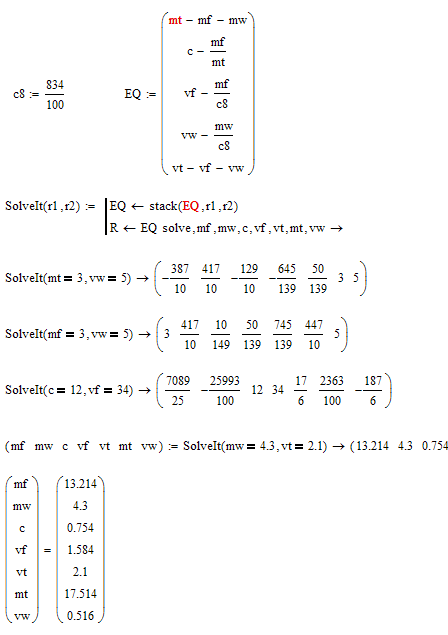

I find myself constantly using a system of 5 equations with 7 different variables. I always know two of the variables, but the two that I know changes. Is there a way to write a single calculator that can solve for the unknowns instead of writing a different calculator for each combination?
equations:
mt=mf+mw
c=mf/mt
vf=mf/8.34
vw=mw/8.34
vt=vf+vw
Using the solve function only lets me solve for unknowns, so I'd have to rewrite the unknowns each time.
Using the find function requires me to guess, but I don't know how to distinguish from a known and a guess.
I could use if statements, but I'd have to write a huge set of formulas, which isn't ideal.
Any help would be appreciated.

Something like this:

December 29, 2016
You can turn Luc's solution into a function with the two conditions (the two known variable values) as arguments.
I add those equations to Luc's EQ and solve this system for all 7 variables, so you always get all 7 variables as result.
Drawback is that you have to evaluate this function symbolically.

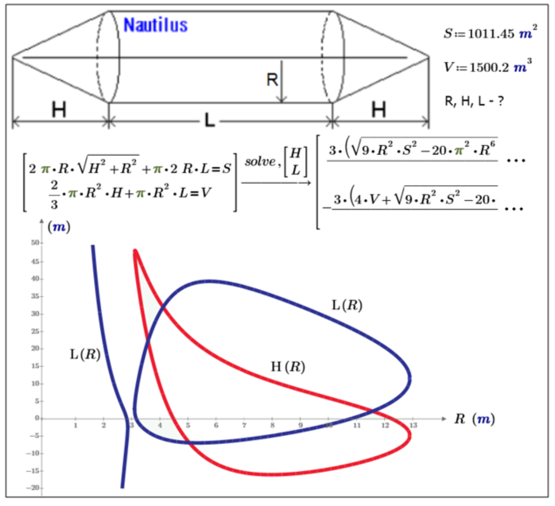

2 equations, 3 unknowns - my solution

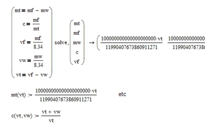

By help user function creating and using:

December 30, 2016
F.M. wrote:
Hi David,
Here below I give you an example of how to solve a non-normal system:
But Davids system is not "non-normal"! He always has a system consisting of 5 equations with 5 unknowns!
Unfortunately, while the 5 equations are always the same, the 5 unknowns vary and can be any of 7 variables - 2 are always known.
As he does not want to create 21 separate solve blocks or symbolic solve statements, he was asking for a more compact solution.
December 30, 2016
Hi Werner,
fortunately I have based my answer on the header of the problem providing  a generic  example, but I have not even looked at the given system.
Bye
