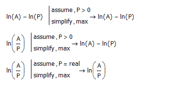

you must also realise that Mathcad's symbolics will generally take all kinds possible considerations into account. So it will not simplify
to
probably because P could be 0...
In short: Mathcad will not teach you how to solve mathematical problems, but it can surely be a great help in checking your steps when solving.
to
It is a question of both domain, and what is considered "simpler":
