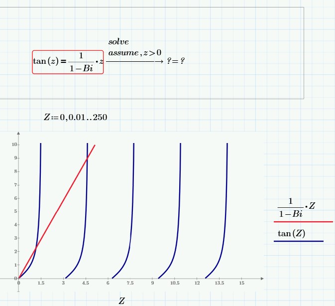

Thank you very much for your reply. Unfortunately, I still have a problem with this exemple, but now I am able to show you exactly what I mean.
Let's say, I have to solve this. I need at least 7-8 first solutions of this equation. I could use given/find, but I would like to change parameter Bi in the future and then I would have to change guess values as well. Any suggestions? Thanks in advance
RichardJ19-TanzaniteAnswer
December 14, 2015
Turn the solve block into a function of Bi and z. Then you can pass it different values of Bi and guess values
