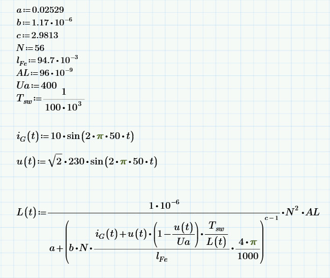

i have got to solve an equation that depends upon itself. I have attached the mathcad file.
When i try to evaluat the solution at a certain value of t, i get the message that the evaluation leads to an infinite recursion.

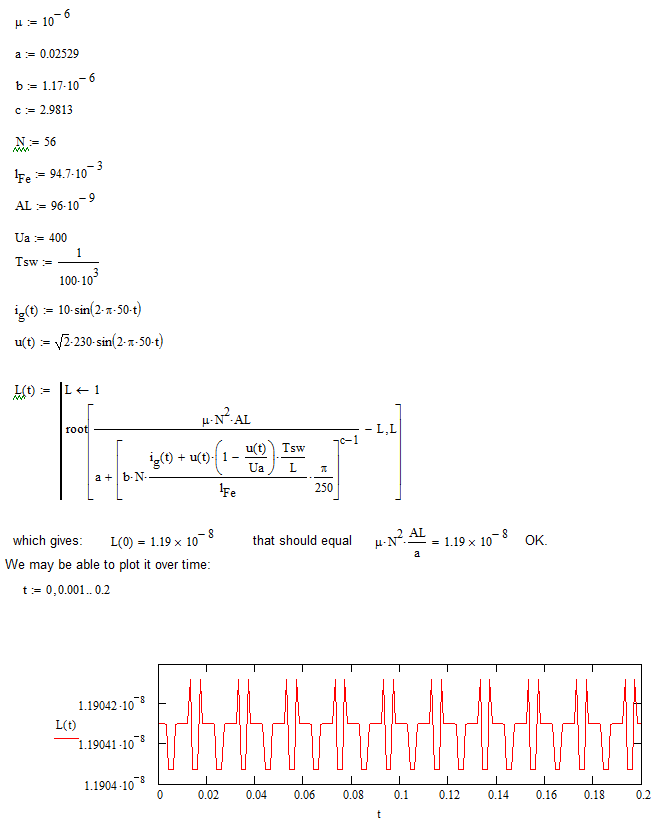

That's a nasty implicit equation you have there.
If I remove all (t)'s I get:
But for t=0, notice that ig(t) and u(t) are zero, so you get L(0)as:
Hope this helps.

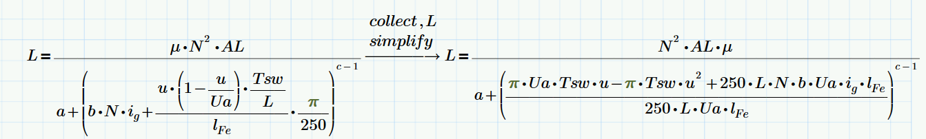

That's a different best you're dealing with, Fred. Look at how you placed ig.
And also notice how it kept L on the rhs.
So it's still implicit and not 'solved'.
23-Emerald V
September 15, 2016
Now if you dress up the equation to something like:
Look at the scale, not much variation in L(t)
Does this come any near to what you expect(ed)?

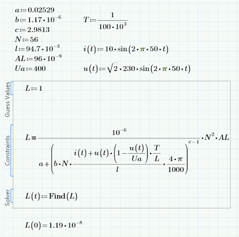

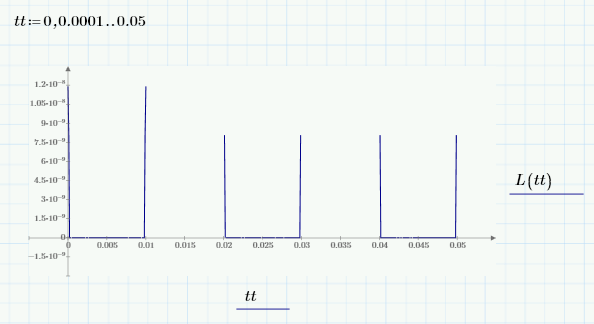

Sometimes a solve block is the short answer.
September 15, 2016
What about a solve block?

Thank you very much, i was able to solve the problem with your help.
