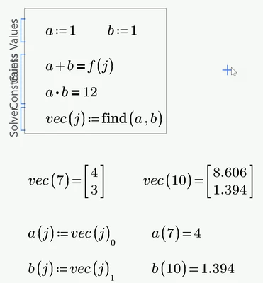

The solve block with "find" can only be used to solve for variables, not for functions.
But the solve block itself can be turned into a function of j as you already did when you wrote vec(j):=Find(...).
You must omit the "(j)" part from the variables you are looking for to make them simple variables and not functions.
Simple example:
Not seen in the screen shot - the definition of f is f(j):=j.
BTW, its strange that in your pdf part of the equations are written in blue which usually indicates units and  not variables?

Try removing "(j)" from each of the inputs in the Find function.
You're getting this error because Find looks for the guess values, and it's looking for them as defined previously in the solve block, even if you've defined them as functions. Try writing:
vec(j) := Find(e'M, e''M, Clfit)
It's fine to write "vec(j)", though, because it's outside the Find function. You will have to call it later, outside the find function, with a specific j to determine its value, and it will work as a function with different values of j as well.
