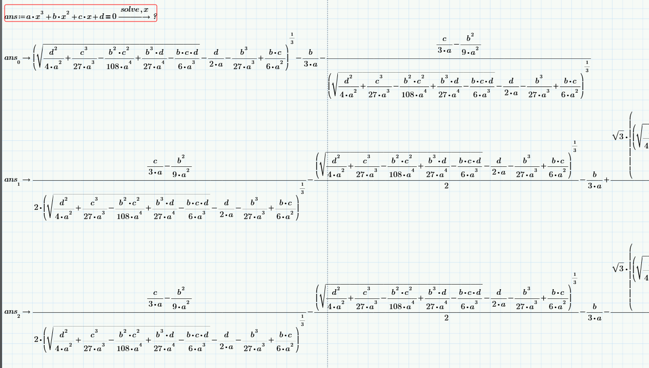

What's the problem you're trying to solve and why do you want Cardano's formula (method?) specifically?
If you're concerned about numerics then, as Valery showed, the symbolic processor will handle cubics.  Here's Prime's solution to the canonical cubic example ..

I would like to apply this method as alternative to Polyroot for calculating "Andrews bell" for the vapour-liquid equilibrium of elemental mercury. The volumetric cubic equation ( e.g. Peng-Robinson ) is coupled with the isofugacity condition.
