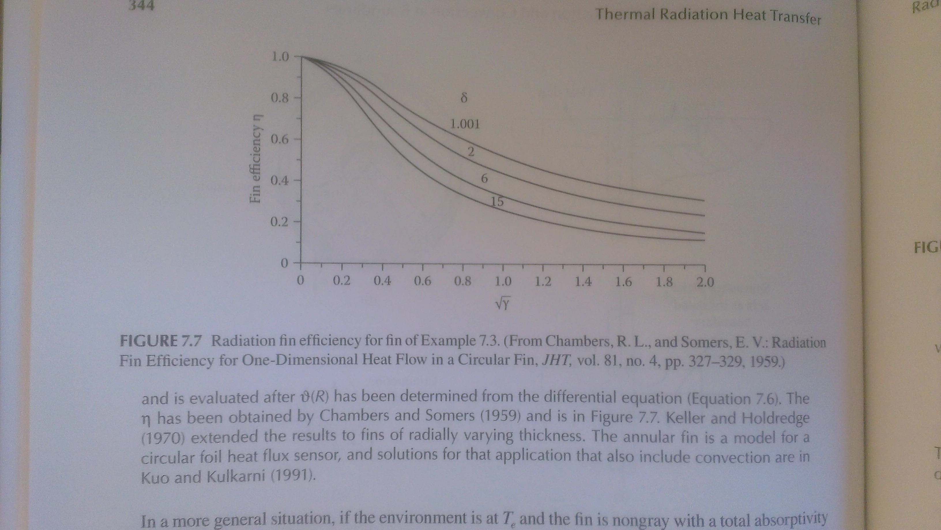

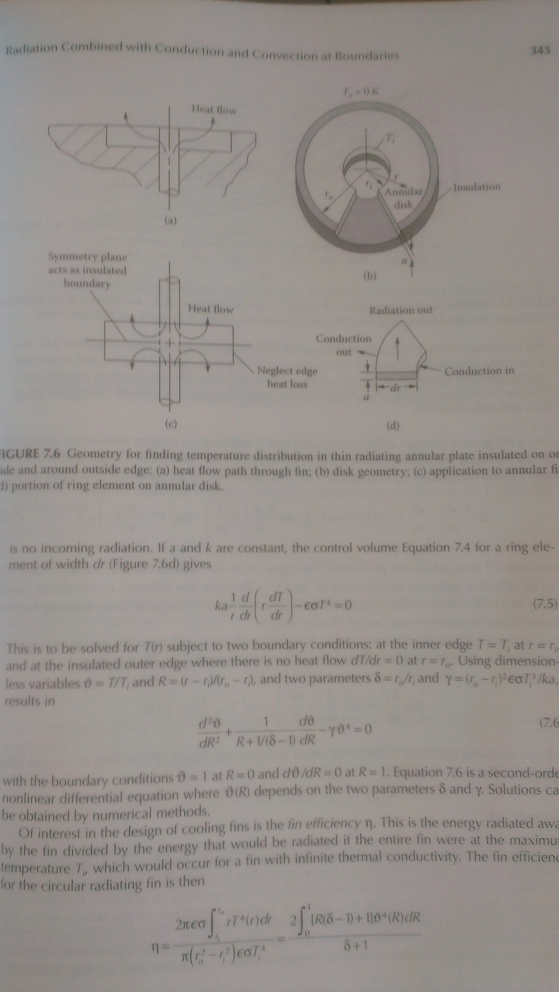

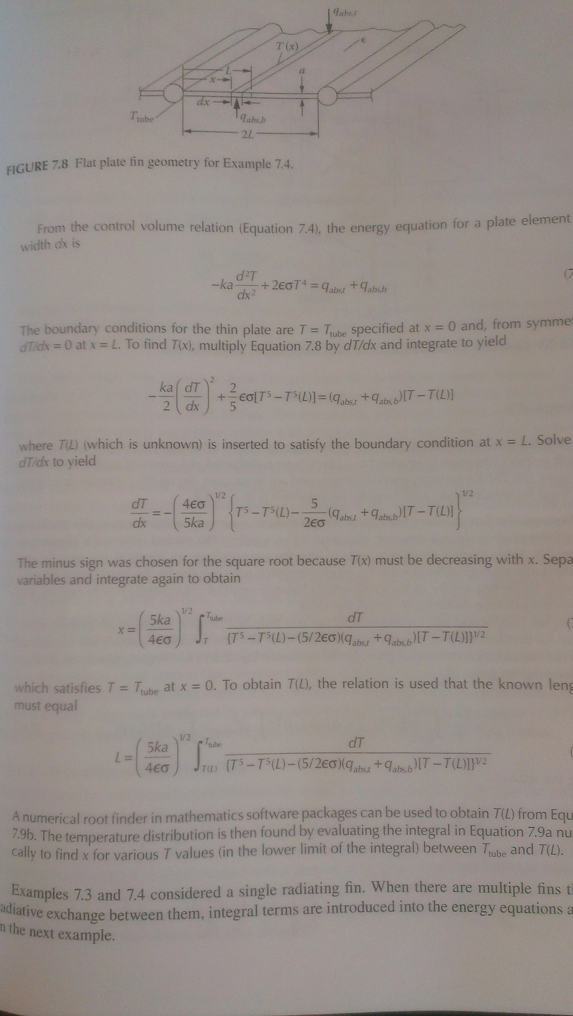

Attached is a worksheet and a few pictures of the example problems I am trying to solve, in which there is a graph showing the solutions. I am hoping I can get Mathcad to solve the equations as a function of parameters.
