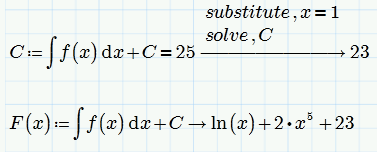

Of course you can solve this specific equation symbolically with Mathcad, too, as its a simple integration.
Here is one way:
and here is another
