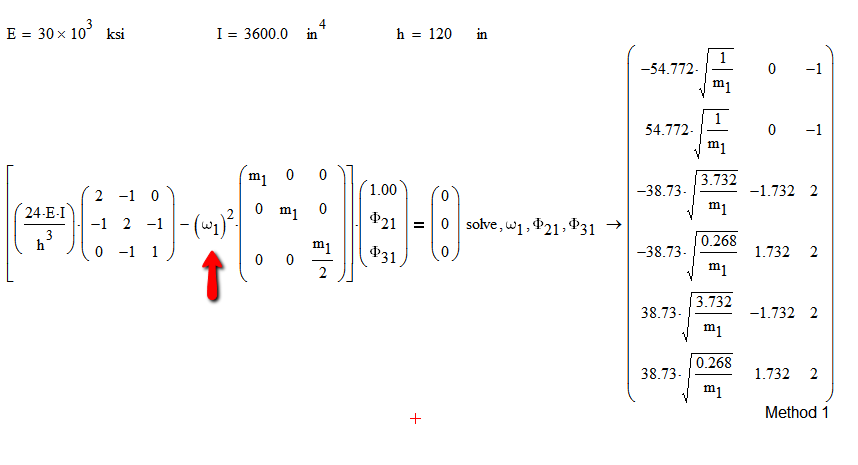

The first method has three equations and only two unknowns. The m.1's all cancel. Put the omega.1 variable back in and solve for it too.hw6_method_1.png
It found 6 solutions.
