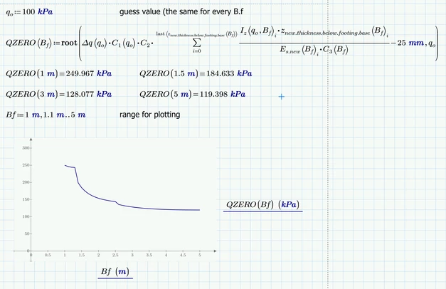

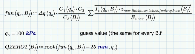

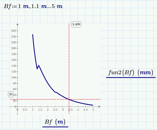

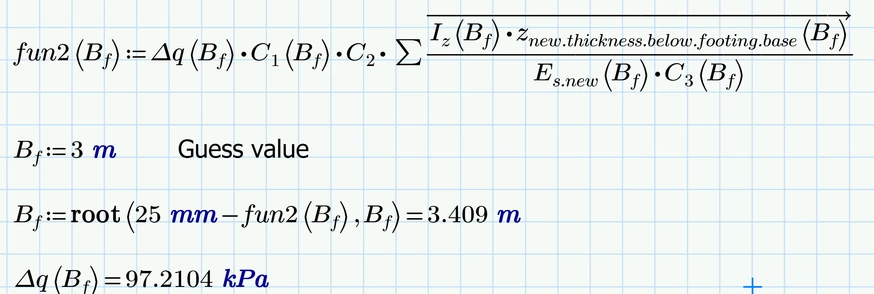

So you should solve the equation for q0 and not for B.f. You can make the solution a function of B_f as explained in my previous answer.
You may use either a solve block or the root function - its up to you.

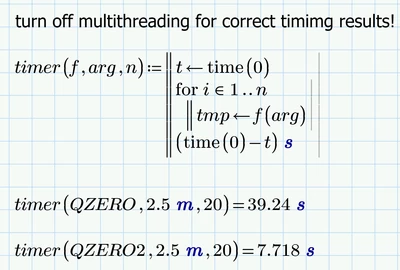

You can speedup the calculation significantly (factor 5) by using the approach which I already showed in a previous posting

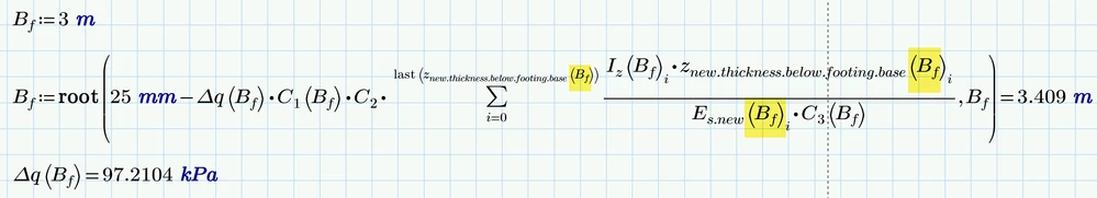

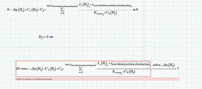

  • The symbolics can't do well with conditional expressions, so you should rather use Primes numeric methods (either a solve block with "find" or the "root" command.
  • I guess you rather want to solve for B.f and not for the function Deltaq(B.f)
  • Again you used function names as if it were simple variables! If you use a function, you have to provide the function argument!
You could also do it that way:
or maybe even that way

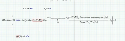

fahmed-214-AlexandriteAuthor
Jul 11, 2023 7:56 PM UTC
What if I have two variables to solve!!
Jul 11, 2023 8:45 PM UTC
Then you would have to use a solve block.
But two variables and just one equation????

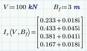

BTW, do you really expect non-real results here?
