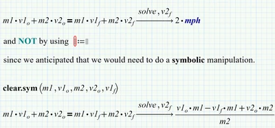

Specifically, page 5 when adding the "solve,v2f" operator to the equation at the top of the page, it is solved numerically ("2.mph") instead of algebraically.
Which makes the whole demonstration of this exercise fails (to my point of view).
What should be done in latest release to show equation solving without numerical resolution ?
The sheet refers to a feature called static symbolical evaluation. Its not available in Prime.
The simplification is done symbolically, but because the involved variables were assigned values before, the symbolics takes these values in account wen solving for v2f.
You would have to clear the variables - either completely (using clear(..) ) or just for symbolic evaluation:
