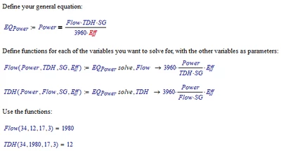

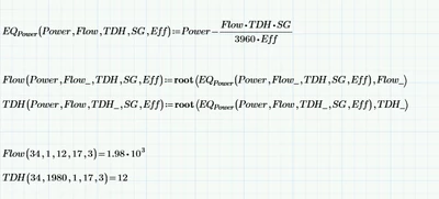

I would like to enter the equation into MathCad Prime 6.0: and solve for any one of the unknown.

Like this:

Luc,
Thanks for you assistance..
I have several follow-up questions but.. I need to get this method to work.. I
I am having difficulty in getting this to work.  Not sure what I am doing wrong.
Defining Equation EQpower:=Power=Flow*TDH*SG/(3960*Eff).  ERROR:  The variable "Power" is undefined.

Or, numerically, in Prime:

I got this to work...and understand it.  Thanks... the root command should work well for all my equations.
I prefer the first method because it is more transparent to a third party.  It shows the equations solved for the unknown.  It also is less confusing by passing a guess.
