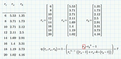

Would love help with this.  I've defined my function, inserted a table of values, and am expecting results in a vector format.
HELP!!

Please attach the Prime worksheet, not just/only a picture.
Some upfront advice:
1. Make sure that k is defined.
2. Vectorize the expression at the right-hand side of the definition.
3. DON'T evaluate a definition. That is: do NOT put an '=' at the end of a definition. It may work in many cases, but in ever so many cases it leads to problems. Use a separate region to evaluate your expression.

You have to delete the equal sign after the function definition and evaluate the function in a separate region.
Furthermore I guess you will have to vectorize the function call as you will get wrong results otherwise.

Another option would be that you don't define a function but a simple variable eta:=...
In this case you would have to use vectorization as well but you could use inline evaluation (the = after the definition). But for some reason inline evaluations have proven to be instable in some situations and so I suggest not using it.
BTW, inline evaluation never works when defining a function.

File attached....
I am really new at this so I appreciate the patience...
When you say "vectorize" the function, how is that accomplished?
