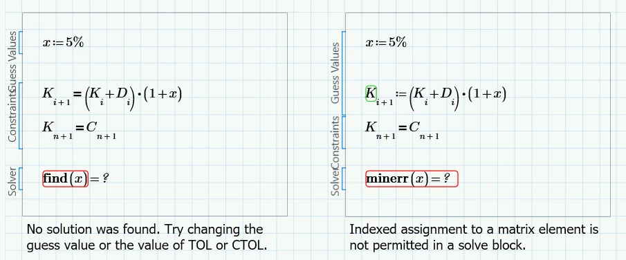

I am trying to compute the equivalent annual percentage rate (APR) for a series of variable deposits with variable returns.
Using the “find” function results in the error message “No solution was found...”. I tried opening up the TOL value, that didn’t help. So I tried the “minerr” function next and a different error message is displayed “Indexed assignment...”,
My questions are:
  • Which of the two errors is relevant?
  • Can I solve equations with indexed constraints in a solve block?
MP11 file is attached.
Thanks for your help,

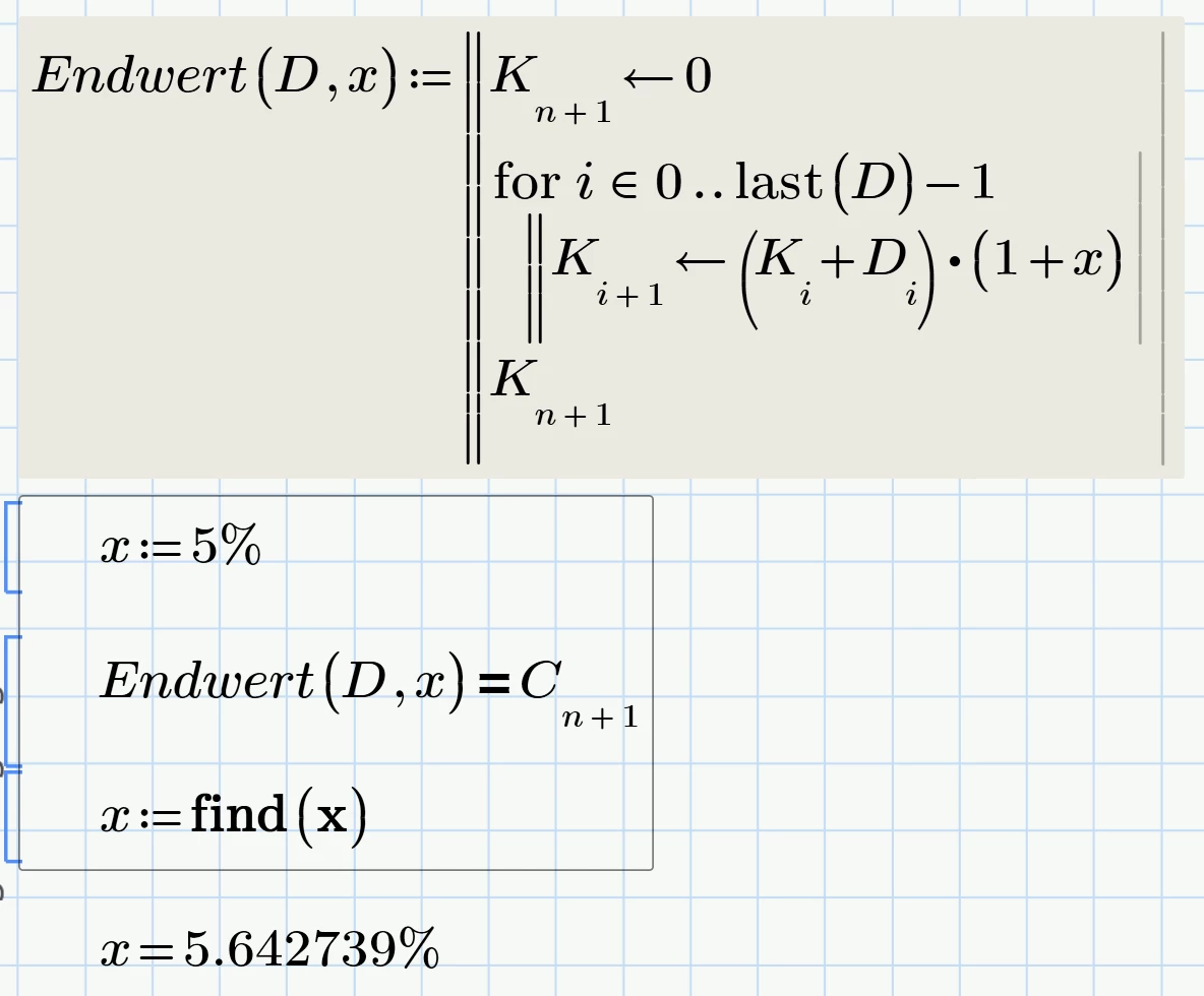

One possible way is to define a function which calculates the end value of the iteration for a given percentage x and use it for the constraint in the solve block.

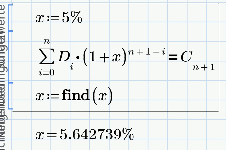

Of course you could also calculate the end-value simpler using the summation operator:
That way you could do without defining a function but instead use the sum directly in the solve block:

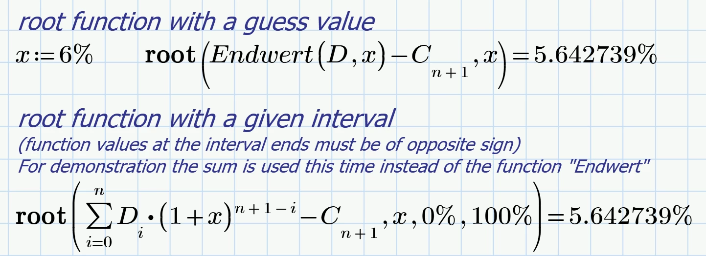

You may also consider using the “root” function in one of its two flavor instead of the solve block:
Werner_E25-Diamond IAnswer

May 18, 2026 3:01 PM UTC
Thanks for your answer, Werner. So I guess the “Indexed assignment...” was the problem and this type of formula can’t be solved for a certain index. The formula with the range variable seemed to be a quick way to replicate an Excel table doing the same thing. This seemed easy until I was trying to solve for an index of the range variable.
