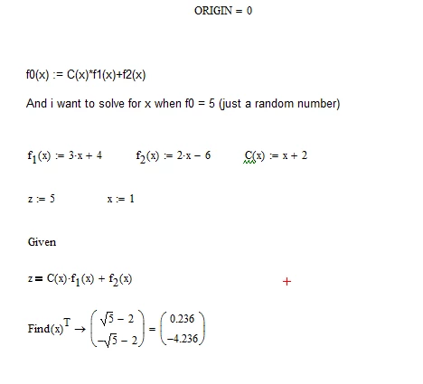

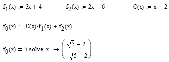

Here's another way to solve this problem:

Symbolic evaluation of solve blocks only work in real Mathcad. This feature was broken in Prime and chances are that the OP is using Prime 7 (given from another thread he opened a while ago). BTW, if you use symbolic eval, no guess value for x is necessary.
But of course the solve block can be evaluated numerically in all versions and if you add a constraint like x>0 or x<0, you have control over the solution calculated.
November 2, 2021
Out of habit, I set the initial condition, since I usually use a numerical solution. Symbolic result - to show the same answer as yours.
