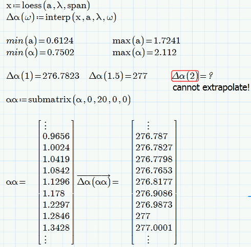

Anyway, its wrong to use the range variable i as index here and is one of the reasons, the interpolation fails. The first and second arguments of loess have to be vectors. And a and lamda are of equal maginitude anyway (61 rows each).
2) the number of rows in each cases are equal, viz. 61 rows are in each matrix.
Nevertheless you changed the order of a and lamda in loess and interpolate which is wrong! Whatever kind the values of omega should be (lamda's or a's), that vetcor has to be first. Guessing from the plots you do this possible should be lamda (independend variable) first, then a (dependend variable). It has to be the same order in loess AND interpolate.
3) I am a newbie in this software, I dont know how to vectorize one expression. If you kindly help me to find this out, I will be oblized.
The function you get with interpolate expects a single scalar as argument, not a whole vector. To let Prime take the elements of a vector omega one by one, feed them into your function and return a vector of results you have to use vectorization (the arrow over the expression) which you get from the operators menu bottom right.
4) Thank you for this. That should be alpha. But the problem is that, in that case, the error tales me " the values must be an integer."

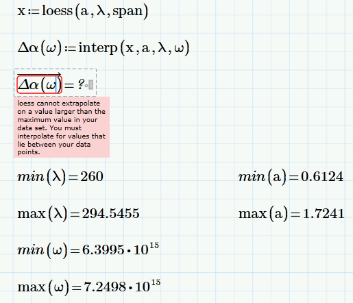

This error is because of the index i in the call of interpolate. As the a values are in the magnitude of alpha I guess a should be the independend variable of your function Delta_alpha, so the order in loess AND interpolate has to be a first, then lamda. The interpolation will not work though, as the localized polynomial regression (loess) you have chosen for your curve fit does not allow extrapolation. It will only allow arguments within the limits of a, that is from 0.6124 to 1.7241. Because the max value of alpha (2.112) is bigger than 1.7241 the function fails.
You will either have to use a different kind of curve fit. Maybe a different kind of reression, maybe an interpolation (polynomial?) instead of a regression - I don't know about your needs.
Later in the sheet I see that you still try to feed very high omega values in your function (inside the integral) - this sure has to fail again.
In the screenshot below I simply took a subvector of the first 21 elelements of alpha (which are in the allowed range) to show that the function work if setup the correct way:

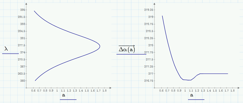

Some other remarks. If you really are after the inverse of lamda-->a you have to be aware that its not unique! E.g. you get two values of lamda for a=1.
Also when I look the the two plots below I think that the function you get with loess is not what you want. For an interpolation to work the function has to be unique and the values of the first vector have to be in ascending order.
