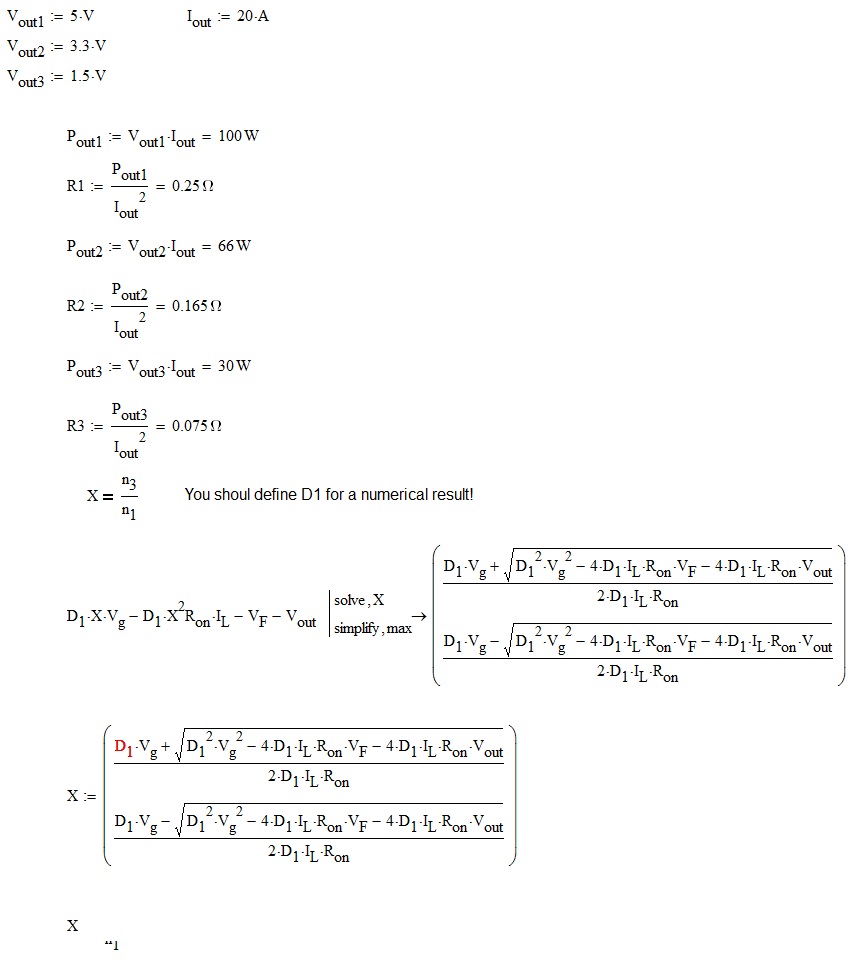

It has been about four years since I have touched MathCAD. I'm having a little trouble figuring out how to solve for two variables in a symbolic equation. Please see the attached file. This is in MathCAD 15. I've looked through my previous MathCAD files but haven't come up with a resolution yet.
I didn't think I needed to define every variable, but I tried doing that and I just end up with 0's.

Thanks F.M., I don't remember doing it this way. I got it to work though!
Is there a way to pass the solution into another variable without having to copy/paste?

You turn it into a function:

Thank you! That will be very helpful going forward
