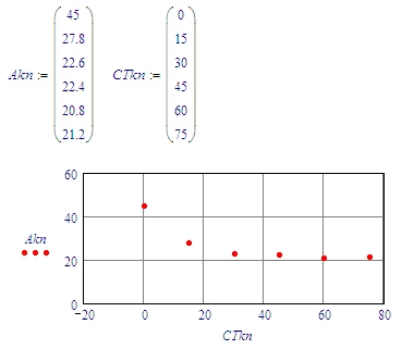

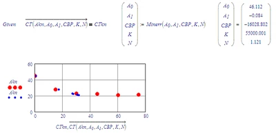

I have some experimental points, and I need to fit this with a equation. But the dependence of variables is related wtih a second equation. The problem is explained in the attached file.
Can somebody help me?

Let's establish that the following is known:
Furthermore these equations are given:
Using the first, we can write A as a function of r:
but we can also write r as a function of A:
And that is much more useful, because we cannot write r as a function of CT, but CT as a function of r solves as:
Using this we can substitute r with its function of A, and substitute the third function as well:
So now we have a function CT(A, A0, A1, CBP, K, N).

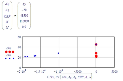

If the supposed solution is entered, and compared to the known points, we get:
The 'solution' is nowhere near the known points (except for CT=0).

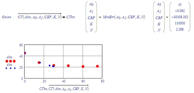

Let's see if we can get a better approximation:
That's more like it.
With these results as guess values, one more try:
I hope this brings you further.

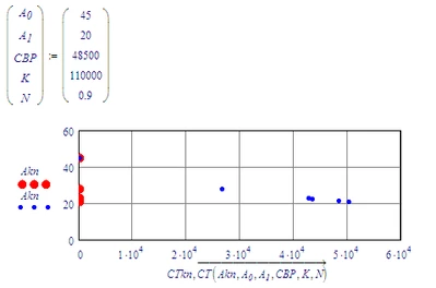

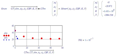

As far as I understand it, is CBP not a value to solve for but should be of constant value 48500.
And the supposed value for A1 is not -20, but should be around +20.

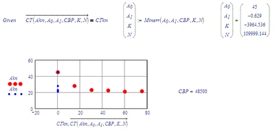

You may consider using a solve block function (or using the root command) to create a function r(CT,K,N) and use this function with equation (1) in a solve block with minerr(K,N,A1).
But I am not sure that the problem is well conditioned.
April 8, 2020
"the supposed value for A1 is not -20, but should be around +20"
OK then:

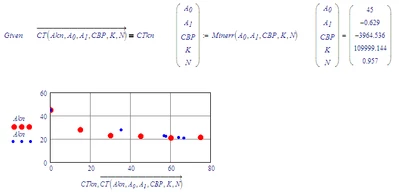

And with these values as guess values I get:
Re-iterating once more causes only minor shifts of the values.
Keeping CBP fixed at 48500:
And another iteration gives:
"I am not sure that the problem is well conditioned". I fully agree.
