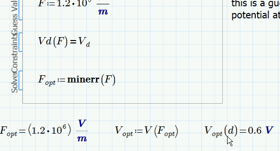

I'm trying to solve a PDE that consists of erfc(x) and exp(x^2) like the file attached below, which is simply a poisson's equation.
Since it has an unknown boundary condition, F electric field at position x=0, I tried 'minerr(F)' type resolution with F declared beforehand by initial guess.
Unfortunatlely, it keeps saying that F in the 'miners' syntax has not been defined.

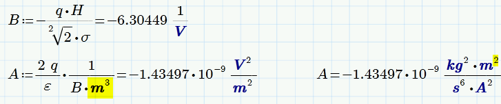

You have a unit problem/inconsistency which makes the odesolve solve block fail, when called. Furthermore you should change the label of F in V(F):=... to "variable".
The meter in constant A should be to the power of 2, not to the power of 5, as they are now. Otherwise you can't add F^2 (under the root).
I am not sure what the error is, you made, but if I boldly add the required units to A
your sheet works OK:

It is my pleasure to have you again for this problem. I tried your tip and it works well.
In fact, I forgot to multiply N_{V} to the coefficient A that has a unit of m^{-3}.
Thank you very much for your keen observation.
