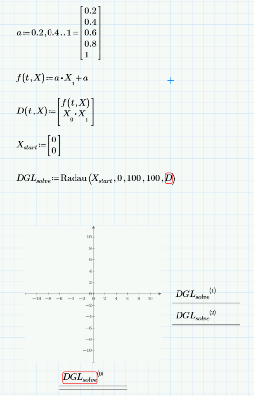

I have a new problem. I want to solve a ODE-system with variable parameter. In the picture you see a minimal example.
I want solve the ODE with variable a so that i get 5 different solutions of the ODE-system. Is there a solution without to use a program? AN if I need a program, how looks it.
thanks for helping!

Hi Fabian G.
Could we know what's the differential equation or is it top secret?
March 24, 2017
Why do you think its a secret?
We see the function f and the vector D, So we know which ODE system is to be solved.
Fabian already wrote that its just a very simple minimal system for demonstration purpose and the goal is not to solve THIS system, I guess, but rather find a way ro make the solution dependent from a parameter a.

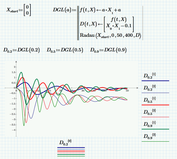

I fear you can't use a range variable for a and plot all resulting functions, but you sure can make the result of Radau dependent of a variable argument a.
Here is a way to do it (I changed the system a little bit to make it more interesting :):

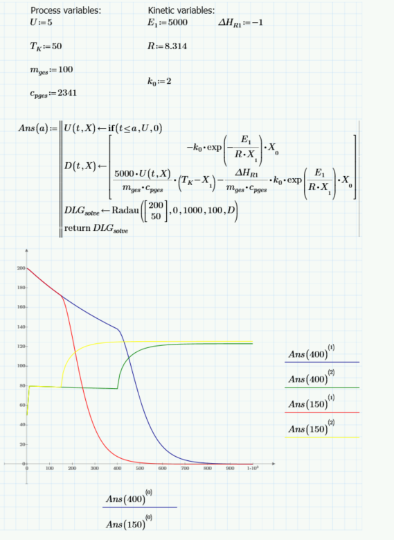

first, thanks for the help. Your solution works, but now i have a problem with units. I try to model a chemical kinetic. Here i give a simply form of it.
It is a first order reaction combined with the arrhenius combination to find a solution for the reaction temperatur X_1 and mol X_0. THerefore i solve a material balance and energy balance. With the fuction U(t,X) i want to simulate a cooling failure. That means at a specific time point a, the cooling is stopping (With Cooling U(t,X)=5, with cooling failure U(t,X)=0).
without units it works fine: (i choose some random number to see something) So know i have a cooling failure after 150 and 400.

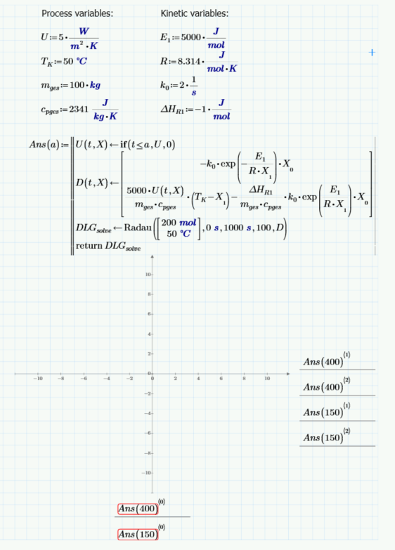

with units i get this

Hi
there must be an inconsistency in the measurement unit:
assuming that there are 5000m ^ 2, we get:

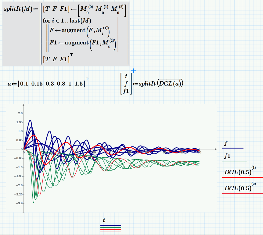

March 24, 2017
If you really need to plot all functions for a set of given parameters with just one command (and in all the same color) you can call the function DGL from my last post with a vector (not a range) as argument and use small routine to separate the various result vectors and create a suitable data structure:
