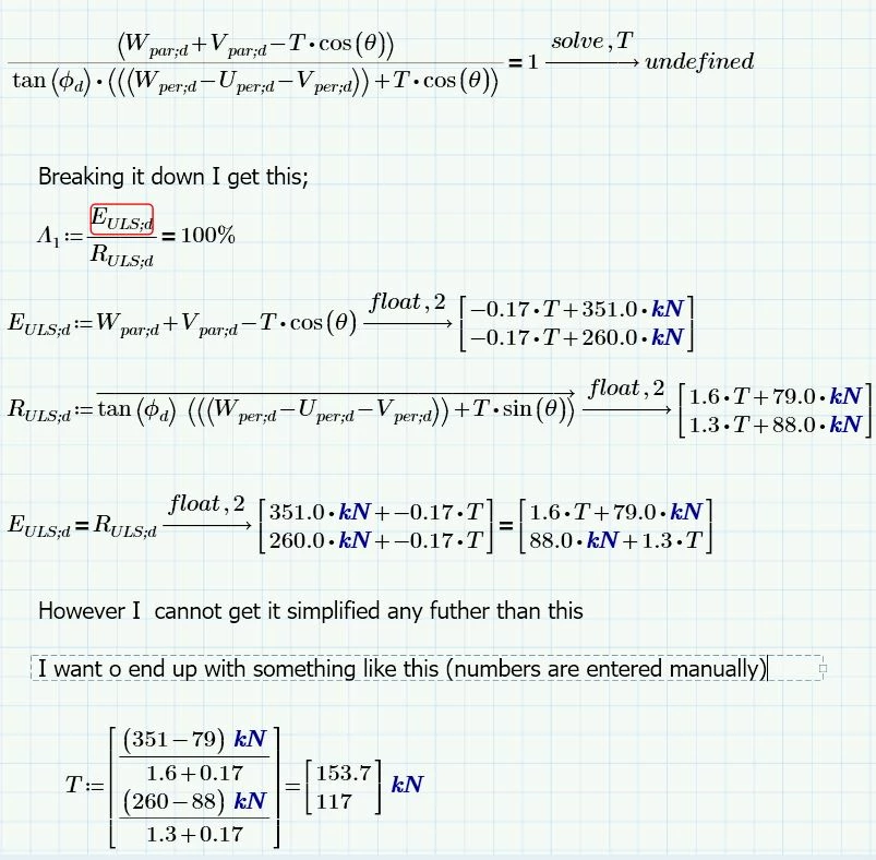

I'm trying to solve the attached equation for T.
W, U, V, Theta and Phi are all defined values.
I can't seem to get solve,T to work. It just says undefined.
I can partially do it by breaking it down but I get to the final step and cant seem to get Mathcad to rearrange in terms of T.
Anyone got any advice?

Thanks,  I've uploaded my sheet for those who wish to help.

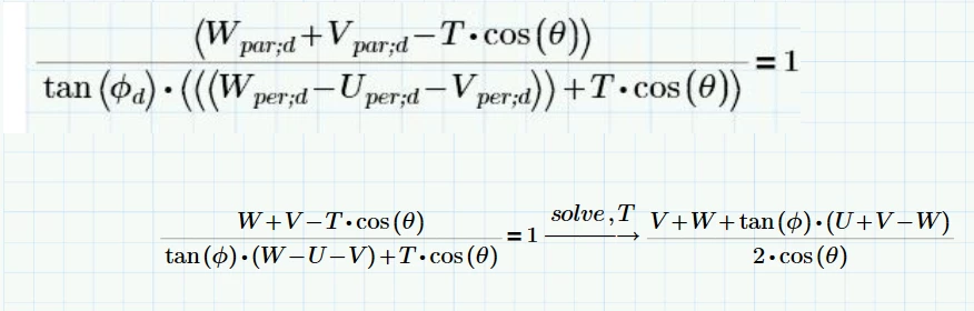

Hmmm!
Without defining values:
June 5, 2018
It solves in 4.0.  You state that your variables are defined.  Don't define before symbolic solving - do it after.  It may be that it's trying to do something that doesn't mathematically make sense with your values. But you can get an answer symbolically.2018-06-05_7-40-15.jpg

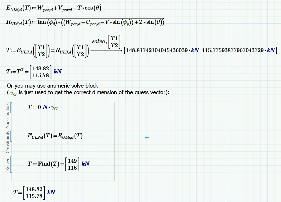

B.PNGWould this help?
