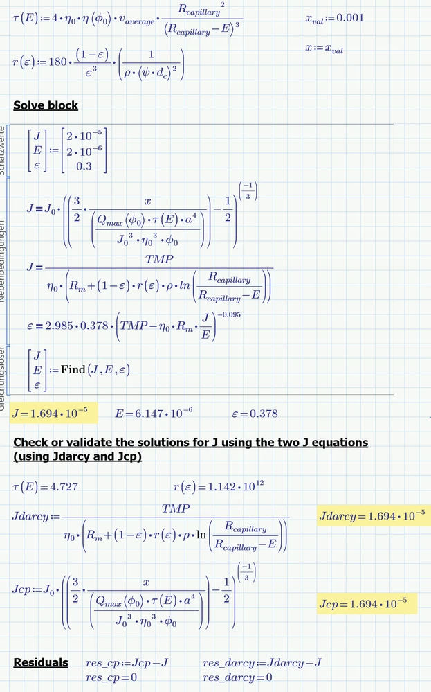

I am working on a system of coupled nonlinear equations and attempting to solve it using a Mathcad Prime 7.0.0.0 Solve Block. The solve block runs without errors and returns numerical values for my unknowns. However, when I validate the solution outside the solve block, I find that one of the variables ( J), which appears in two different model equations, gives two different values when recalculated. I expected these equations to converge to a consistent solution for J, but they do not.
In other words, even though the solve block returns values for three different variables (J, E, ε), the two J expressions do not evaluate to the same value of J when I recompute them using the solved ( E and ε).
I have attached my Mathcad file.
Could someone please review it and help me understand why the solve block returns a result but the two governing equations do not match when checked afterwards?

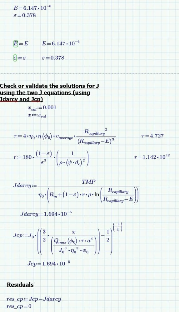

The reason you get wrong results is because of your definition of variables tau and r. These calculations just use the guess values you provided for E and epsilon and do never change!

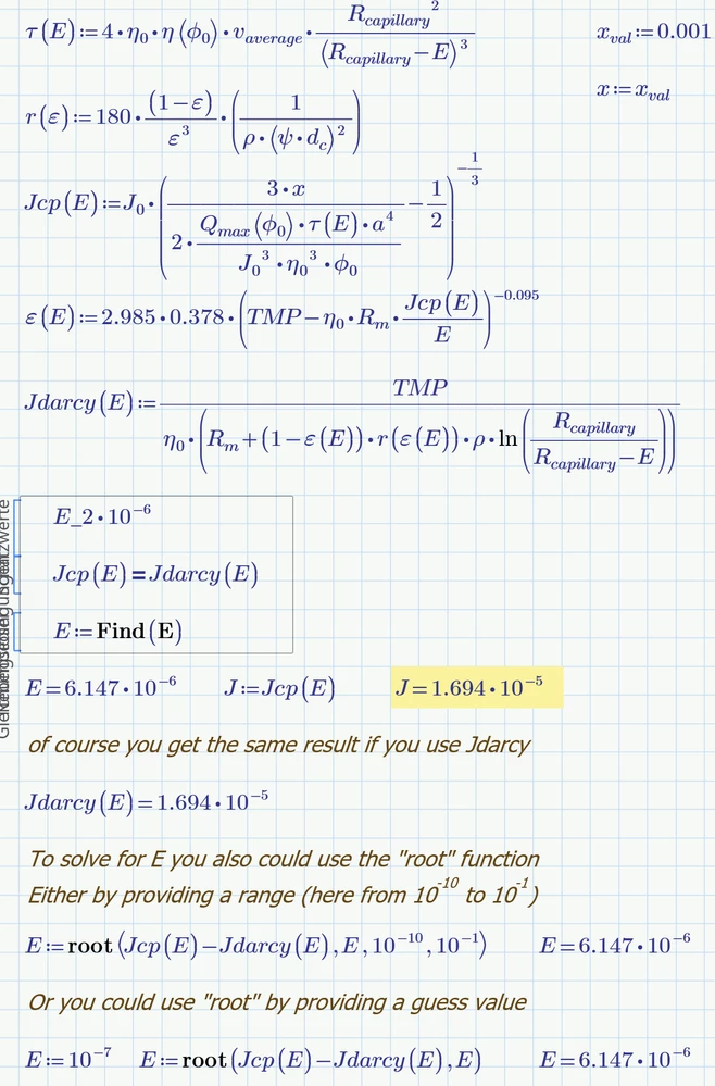

I would suggest to turn tau and r into functions (in front of the solve block) and use them in your equations. As I don't have Prime 7 installed I can only provide screenshots, but I attach the Prime 11 file in case some kind soul is able and willing to convert it to P7 format.

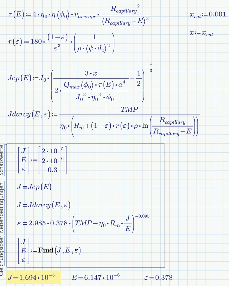

You may also consider turning Jcp and Jdarcy into function and  use them in your solve block:
You may use functions until your task does depend on one variable only, I had chosen variable E. So you just have to search for the value of E and can use this value to calculate J (and if necessary also epsilon). For equations in just one variable you could also use the "root" command.
You have to decide if this approach makes the calculations less clear or not.
