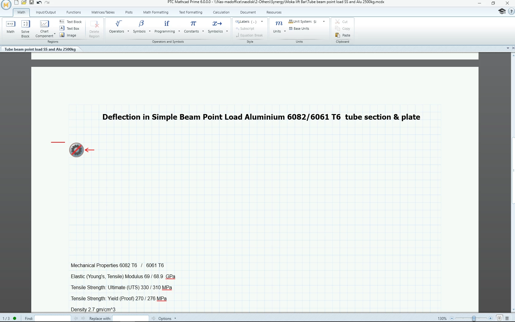

It's a known fact that Prime sometimes corrupts (parts of) its worksheets. So to say, you're lucky it still opens.
You may consider submitting the problem, with your worksheet file, to customer PTC support for analysis.
Try pasting your drawings as pictures.
3-Newcomer
Thanks for the suggestion. But I need to keep the drawing as an AutoCAD
drawing as I may need to edit it when the dimensions change.
The problem was that the drawing was overlapping a text area. I move the
drawing and it fixed the problem
