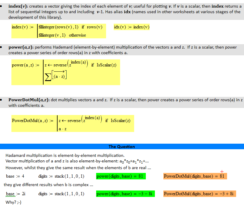

Every engineer, mathematician and scientist is born knowing that the vector dot product is the sum of the element-by-element multiplication of the components of the two vectors. But occasionally, when our brain isn't paying full attention, things don't work out as intended ...

PS.  I blame Valery for this one.  If he hadn't posed that clock question, I wouldn't have tried to generalize it and spend a couple of minutes wondering why my previously fine power series expansion formula wasn't working when applied to complex number bases.
An interesting bug!  It appears that Mathcad takes the complex conjugate of the "z" vector before multiplying!  You can avoid the problem by replacing a*z in PowerDot Mul by aT*z  (where aT is the transpose of a).  Mathcad no longer bothers to take the complex conjugate!
Alan
Interesting.  A bug?
