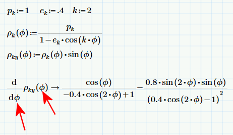

Separate out the function, and it will evaluate.  Don't know why your sheet fails.
Jul 21, 2015 10:56 PM UTC
It's a problem with labels. You have two occurrences of phi with different labels, so Mathcad views them as different. It's equivalent to d/dA(f(B)), which is of course zero. Set the labels to both be "variable" and it works
In Mathcad Prime you have to be careful with labels!
