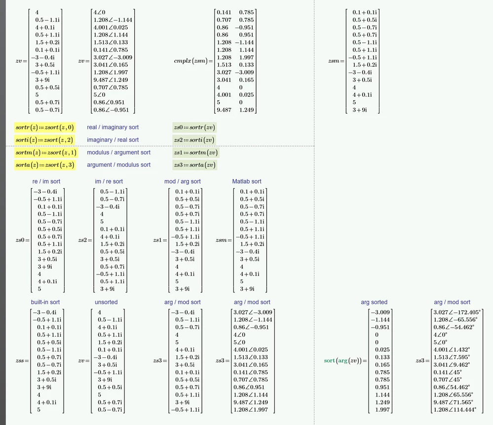

Following on from the discussion re minima and maxima of various Mathcad data types, I gave up on trying to fault-find my original (messy) complex sort worksheet, and present the following simplified Mathcad Prime 11 version for your edification.  It's based on merge sort.
zv is the complex-valued vector to sort, and I've rerun the results in MATLAB.

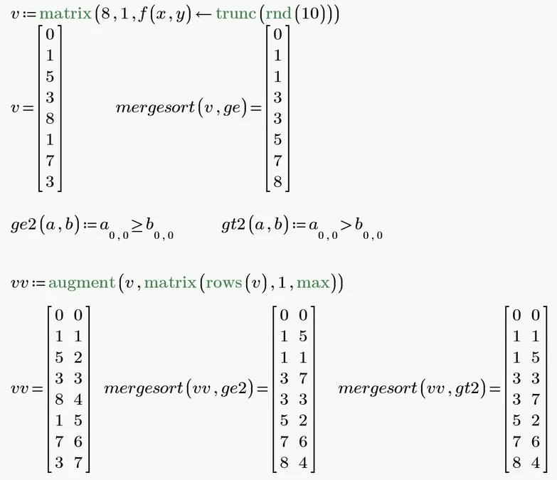

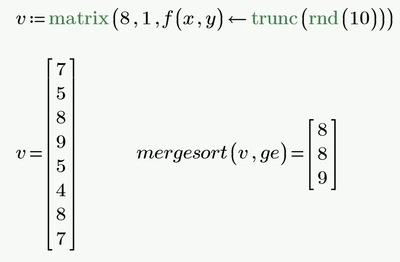

What am I missing?

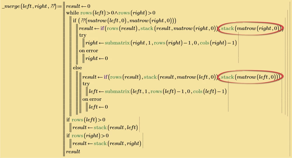

A quick hack to fix the problem with 1-column matrices:
23-Emerald V
Yes, effectively the same solution.   Great minds ... 😈

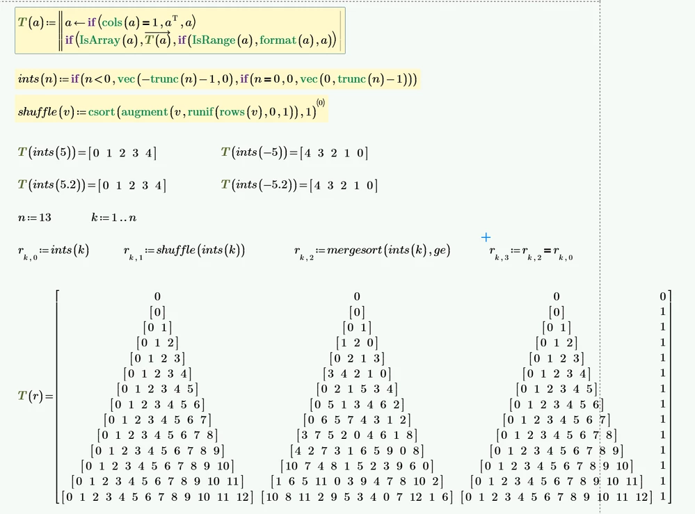

Then I realised that, in terms of testing, I'm busy doing all the barking when I've got a perfectly good laptop that can do that for me:
