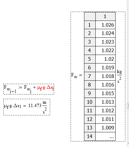

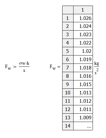

2 I'm a little confused as to what you need.
F.w is defined as:
But then you re-define it with
Mathcad can't understand this recursive form so better to use the same format as you have for t2 & t3 earlier.
{Looking carefully I note that it is F[w*(j) not F.w(j)}
Now that i have corrected for the change of g,
F.w has units of kg/s^2 but you are trying to add something with units of m/s^2
There is an error here somewhere but without knowing what the equations represent it is difficult to identify what that error is.
