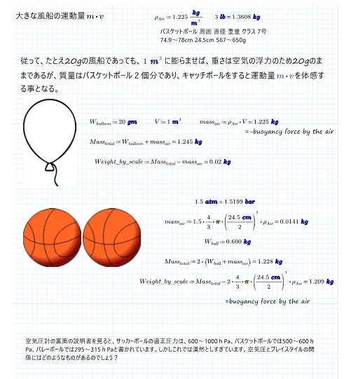

Static state ( On your hand)
They are moving. When you catch them, the speed is v, mass*v affect your hands.
The mass of a large balloon is image.png, Weight of balloon is 20 g.image.png
Therefore, we feel almost the same or more m-v attack in the big balloon than two basketballs.

August 28, 2020
I see you take account of the pressure of the air in the basket balls.
With just (1.0) atmospheric pressure in the big balloon it will look like a weak bag.
I'm trying to imagine how it will fly through the air...
