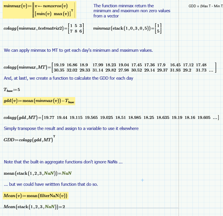

I've had a brief look at your problem, and because I didn't have time to make it short, I've got a fairly long-winded, but hopefully extendable method of analyzing your file.  ... There's a lot more above the excerpt below.   Very roughly, I extract the temperature data and create a matrix with each day's temperature in a separate column.  I then filter out any extraneous NaNs (eg, those at the end of the read-in Excel worksheet.  I then create a function that will apply an aggregate function (eg, min, max, mean) to each column.  The next step is to create a gdd aggregate function and just apply it.
I've attached a pdf of the worksheet so Werner can have something amusingly baroque to read late at night ...
Stuart
October 12, 2015
Thank you for your contribution Stuart. What I usually do for eliminating headers and NaNs is just choosing the column of data I'll be working with. I do this with the READEXCEL option, it pops open a window when I upload the excel file and previews the contents. I just highlight what I want the instruction to read. I think that can save time and effort so you don't have to code your way out of it. Also, I went back into the file and deleted the rows for the 6.10 and 8.10 entries (rows 6674 and up). The NaN in 1526 was removed. With these empty cells I imagine some error is going to spread over my results but the information I'm generating is not meant to be exact to the 5th decimal per se. I wish there was a MathCad for Dummies. Trial and error so far is showing a steep learning curve.
