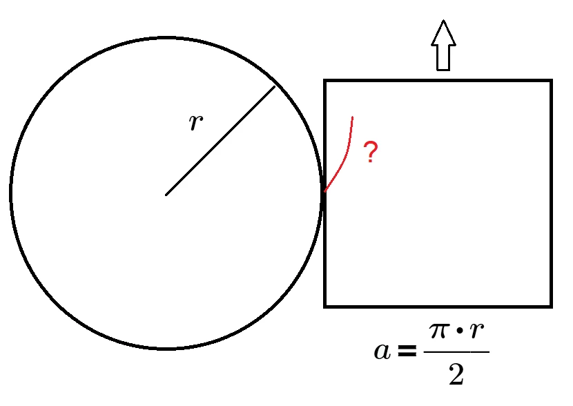

Can you create this "square cardioid" in Mathcad.
With animation!

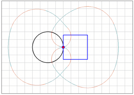

Couldn't wait any longer 😉
Now its your turn! How about a triangle "rolling" on a square or a circle, or, again, the other way round.

I wouldn't call it a square cardiod (even though it would look similar).
The path of the point is relatively unspectacular and consists of three different curves:
1) four quarter circles
2) two parts of an involute of a circle, such as those used in the construction of a particular type of gear
3) two parts of a parallel curve to an involute of a circle
You can also do it the other way around and unroll the circle on the square. The point path then consists of alternating circular and cycloid pieces. That doesn't look particularly exciting either.
