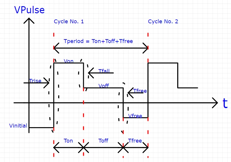

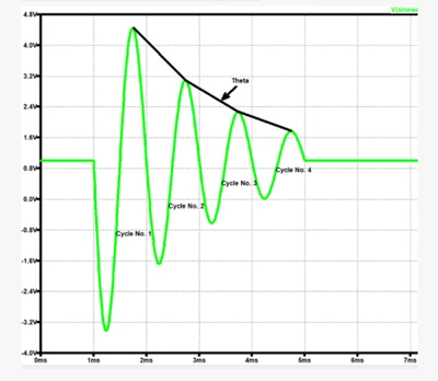

Do you have any idea how to implement in Mathcad 15 the functions that generate the following graphs shown below?
Case 1:

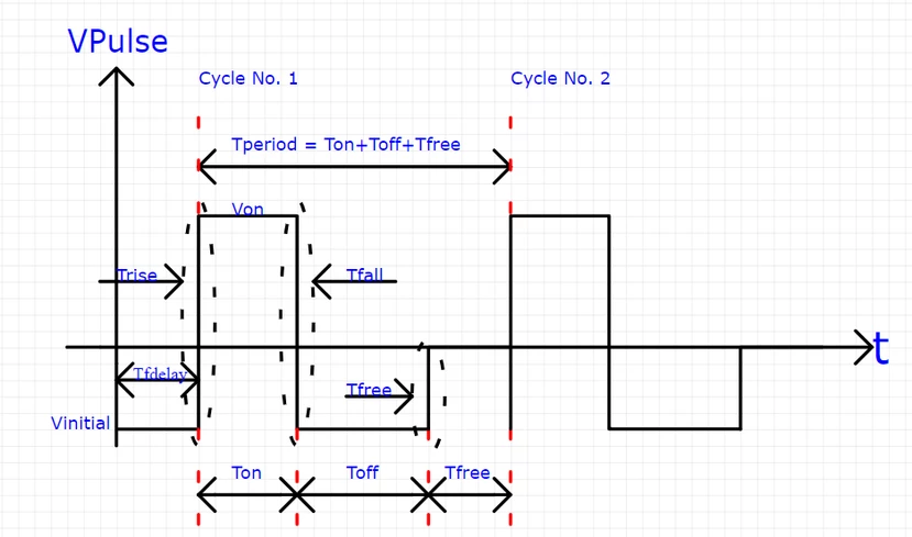

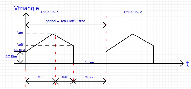

And if I change the parameters:
Case 2:
a)
b)
c)

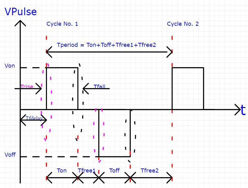

Case 3:
Thank you.

All of your examples except this
can be simply achieved using either the Linterp or sine function along with some time limit constraints.
Let's see (from an Amethyst level member) a sheet at least showing your attempts.
March 12, 2021

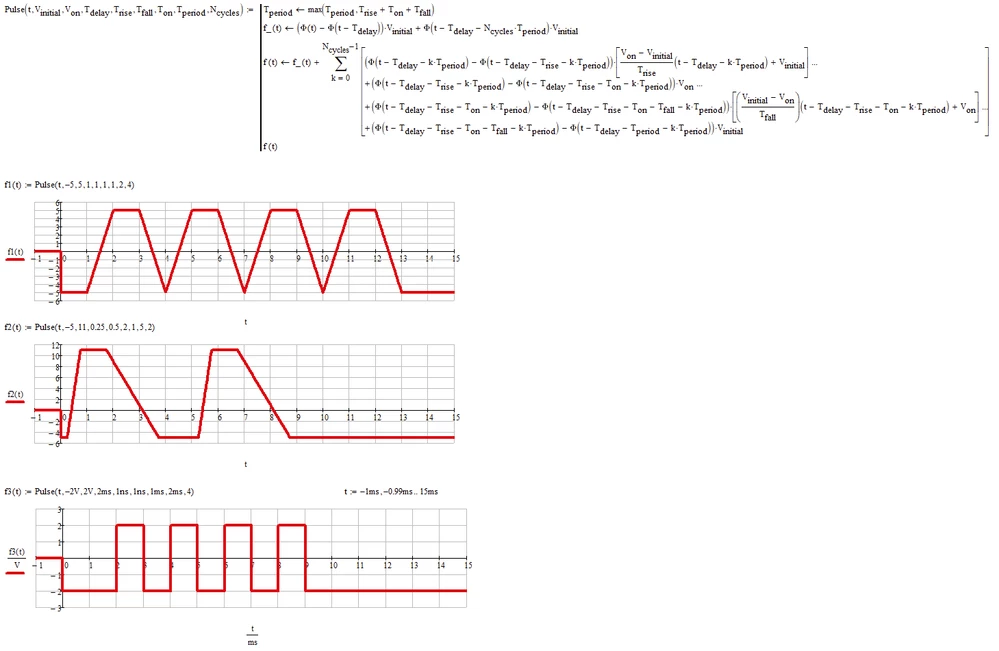

Here is a function for the pulse wave for you to start with.
The function takes the same arguments in the same order as shown in your screenshot. However, the times that you show with arrows in the first picture "for clarity" seem to be quite inaccurate and misleading.

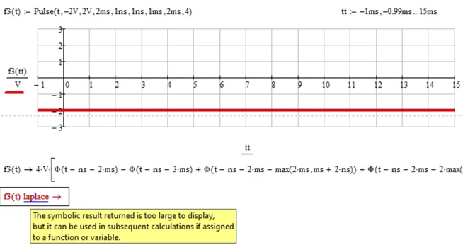

March 12, 2021

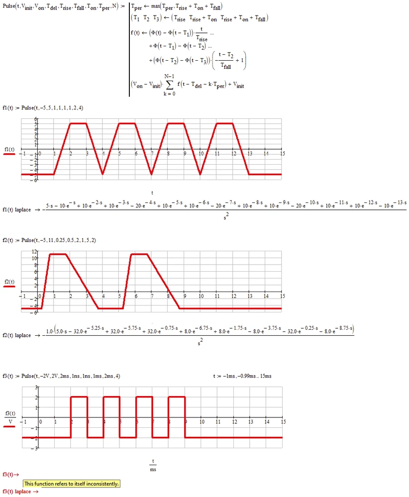

Here is a more compact version of the function posted above.
As you can see in the last example, symbolic operations won't work when used with units!
EDIT: See below.
EDIT My fault. The error occurs because I redefined t to be the range for plotting, should have used a different variable name (normally I use "t." in such cases as it looks like a normal "t".
So you see that the symbolic also works with units, but I can image that a useful result often will be demanded too much. As you should know the symbolic does not know anything about units and treats them as unknowns.

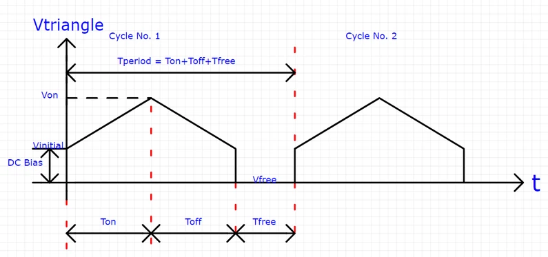

I dare to ask if the following options would be possible:
March 12, 2021

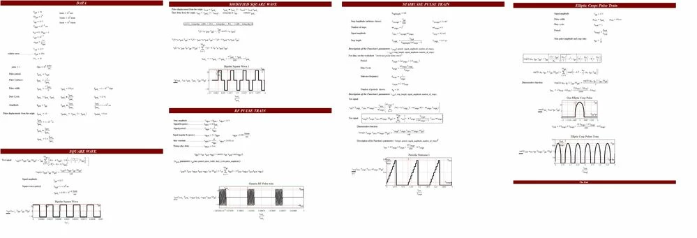

March 13, 2021
All in one without reference files: Signals, data, Fourier analysis, sampling, and reconstruction of the signal with Shannon's theorem ( To reduce processing times, you must reduce N1_, for example, N1_ = 25.). See attached file.
