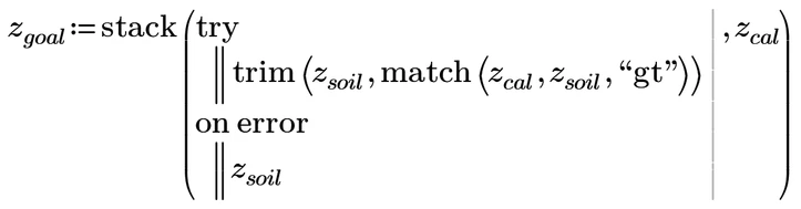

Try
This approach will fail if no value in z.soil is larger than z.cal.
If this is a problem, you may use tray and catch to cope with it
Remarks
Now this approach would give a wrong result if ALL values in z.soil are larger than z.cal.
If z.cal is equal to a value in z.soil, this value will be seen twice at the end of the resulting vector - not sure if this is desired behaviour.
If the values in z.soil are not sorted, you should use sort(trim(....)).

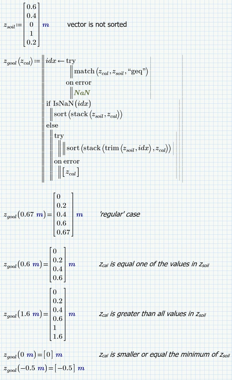

Here is a version which also considers these points. I formulated it as function of z.cal because this makes testing all possible cases easier

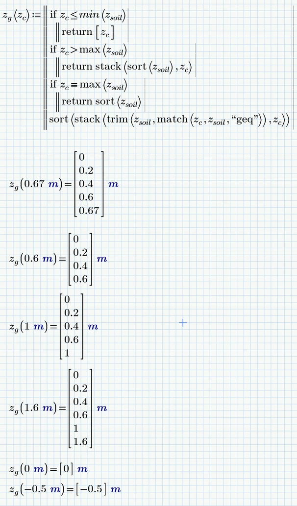

Feb 25, 2025 2:45 PM UTC
Here is a shorter approach which avoids Try and catch and deals with the 'special' cases with simple if-statements, which might be better readable and understandable.

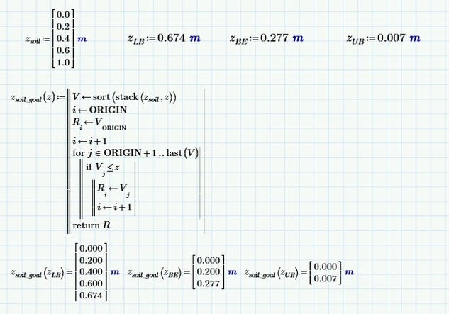

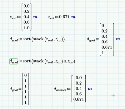

8-Gravel
Feb 25, 2025 2:50 PM UTC
Hi Werner,
Thanks for posting the solution. I found another solution in the forum from another user, I've done some modified in the loop and got the answer, Obviously your solution is better that captures the possibility of value more than the specified range. I will take your formula into my calculation.
