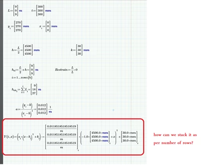

1.When i substitute all variables results of y(i,x) matrix in matrix and hard to plot, How can plot y(i,x) ?

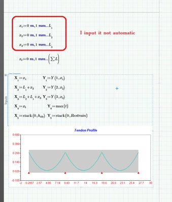

2.After I can not do 1 above I try to manual by stack but Results still  Matrix in matrix,Can we automatic stack the element of matrix y(i,x) (red circle in attachment) ?
3.Or you can revise my technique to better and easy?
thank you

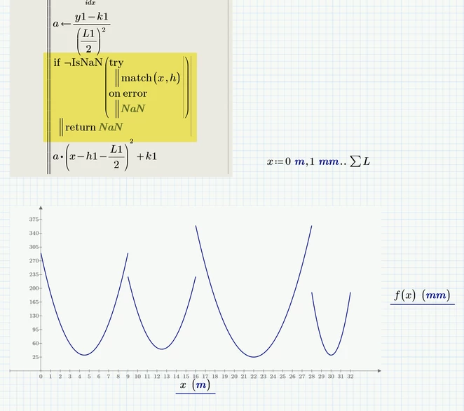

Here is a variant that tries to suppress the vertical line segments between the parabolic segments.

1) What you get are not pure vectors  or matrices because you mix ranges (i) and vectors
2)a) Whats the reason for defining vectors with three times the same value
2)b) What kind of plot do you expect with all values being the same?
3) It looks to me that you are not aware the when you define
you are already defining a nested vector
September 3, 2020
Dear Werner_E
After I remove i (iteration) it still be nest matrix.
My purpose i wanna construct Parabolic Equation continue (n metric)  y=a(x-h)^2+k in single matrix and then we can do matrix operation.
Thank you

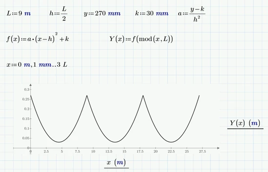

Not sure, but if the goal is to plot a periodic function, you may use the "mod" function to do the job:
Prime 6 sheet attached
