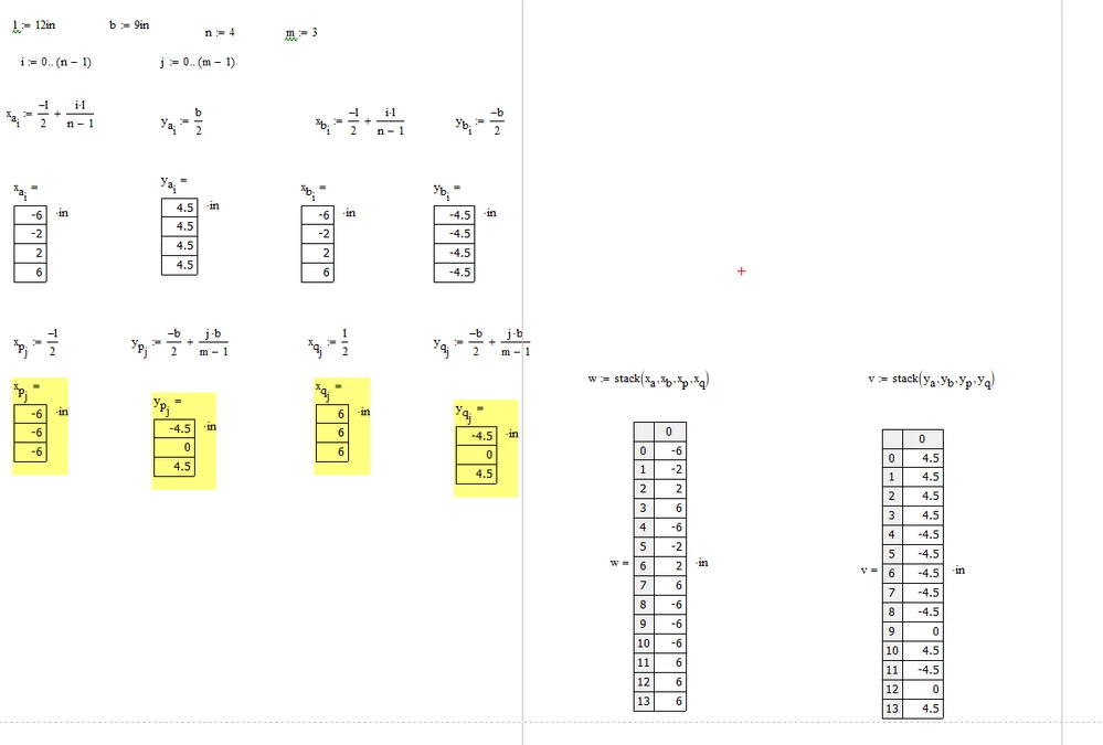

Hi, I was trying to stack all the x coordinates together and all y coordinates together. I see an additional value (0,0) in the result w and v. Can you please tell me why is the additional rows generated and how to eliminate it. And i am using mathcad 15

Maybe because you started indexing at 1, while the default start index is 0?

Lucs guess was correct. The setting of ORIGIN in your sheet is the default value 0, so every vector starts indexing with number zero. You created a range variable j which started at 1 and assigned values. So vector element with number 1 gets the correct value 4.5 in, but there still exists a vector element with number 0. This is not assigned a value and so its set to zero by default.
To display the vector y.a you typed y.a[j= which only gives you the elements defined by range j, but not the full vector. If you simply type y.a= you see the full vector with the leading zero.
Rule: If you use a range variable to define vector this range should start with the value of ORIGIN.

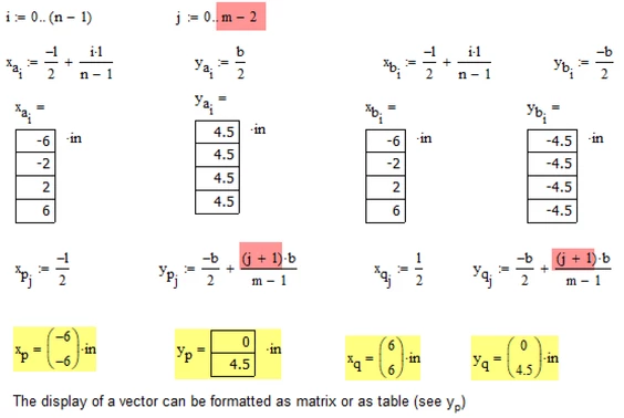

Here a small example to demonstrate what happened:

Thank you for the explanation i was trying to eliminate the set of coordinates which are repeated. They coincide with the vertices of the rectangle, by starting the index j from 1 i wanted to eliminate the repetition. can you suggest me a way to remove Capture2.PNG the repeated coordinates?

Do these changes address your problem?
