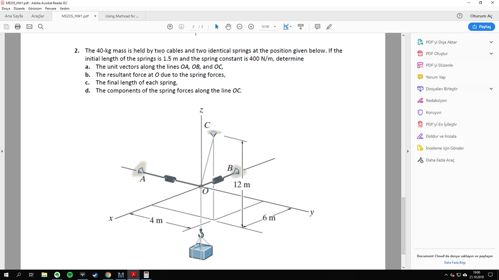

You're right!  If the positions shown are equilibrium, the the problem is different.

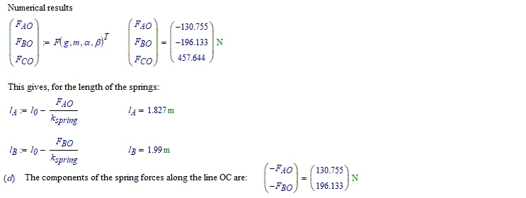

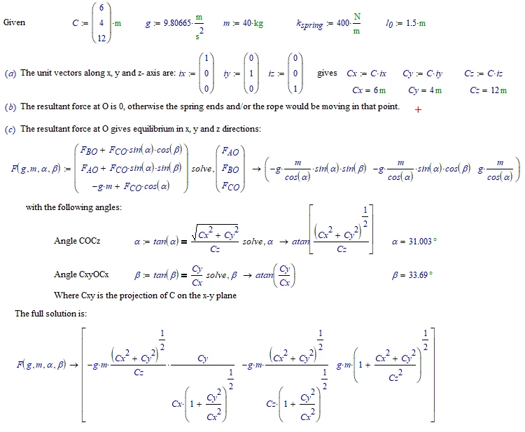

Seems like a homework problem with a good faith effort to solve. Easy way to solve with Mathcad is to use solve block to solve balance of forces. Check attached P5 worksheet or xps file.

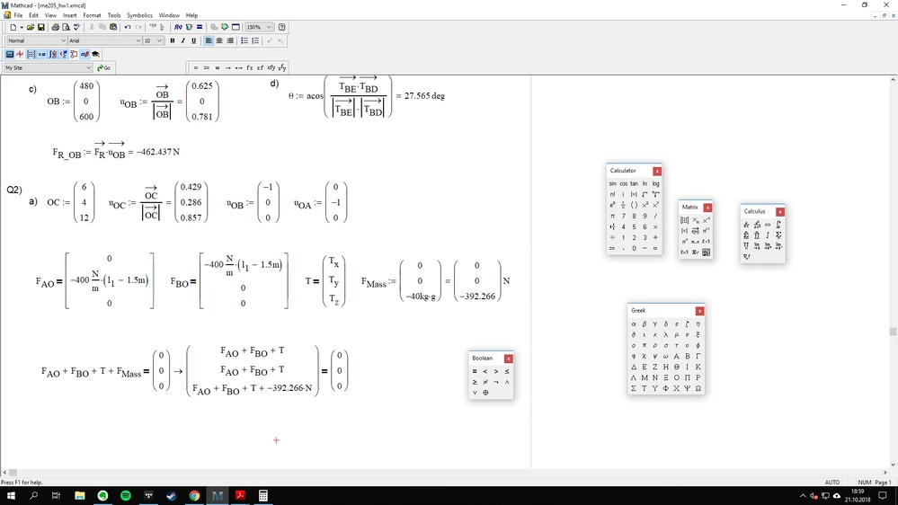

Express will not execute solve blocks; answer to two decimals by trial and error.  Prime 4

Hi Fred,
Interesting solution to a harder problem: the figure text clearly states that "O" is the equilibrium position.
I hadn't realized that Mathcad Express is so brain dead as to exclude solve blocks. My bad; I'm sure I must have read this many times in this blog.
Prime Express is strangely handicapped:
  • no solve blocks
  • no symbolics
That kind of made sense, but
  • the function "mean" is "a premium feature", but
  • integration and differentiation still work.
Those of us old enough to have been raised without solve blocks (hopefully) can still remember the old ways.
Thanks for the good wishes.  I'll still be around, though less vocal.

Here's a solution in Mathcad 11, you should be able to read the attached file using Mathcad 15.
