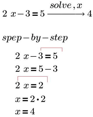

I really would appreciate if Prime would allow at least a manual stepwise treatment of an equation like other software has no problem to do.
Here the free GeoGebra
Second expression is done by typing #1+3. And of course all the other commercial CAS's like Mathematica or Maple are able to do so as well.
And here is Prime9
Also badly missing symbolic functions which wold return the RHS or LHS of an equation.

The big drawback here is that you have to manually write the same operation on both sides which is failure prone. What would be needed is a way to write the desired operation only once to get it applied to both sides of the equation.
But Prime does not offer a way to handle parts of an equation or apply operations on equations.
