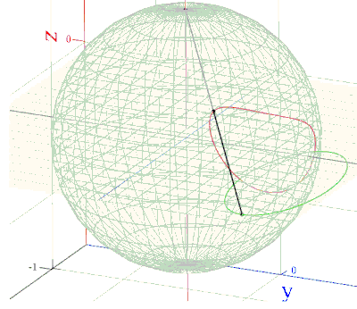

Looking for something like this?
And in case that Valery is around ...

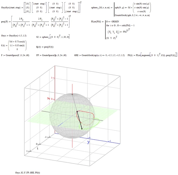

That's exactly what I was looking for.
Thank you very much Werner, you are unmatched.
