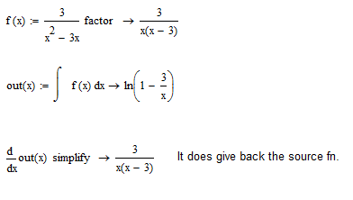

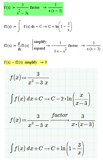

While some bad bugs concerning the symbolics, especially the indefinite integral and the inverse laplace transform were corrected since Version 14, I again found what seems to be another bug with the symbolic integral (see attched worksheet). Mathcad adds a wrong factor 2 to the solution.
Can somebody confirm the bug an log it for correction, please.
