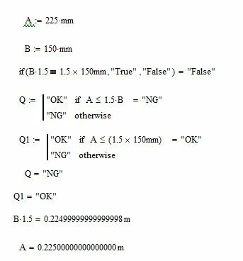

Strange behavior with Mathcad 15
I am not getting why this is evaluating in such a way in Mathcad 15

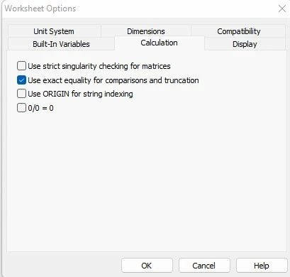

terryhendicott
Aug 4, 2022 9:04 PM UTC
Hi
You can use a setting in the worksheet options:
Simply uncheck the use exact comparisons option.
If you uncheck the exact equality option you get the behavior desired.
Cheers
Terry

Aug 4, 2022 7:24 PM UTC
Hi
Internal precision at 17 decimal places A and 1.5B are not the same.
7-Bedrock
Aug 4, 2022 7:41 PM UTC
Thank you for explanation I was just wondering if there is any option with mathcad 15 to change this behavior with variable?
terryhendicott
Hi
Cheers
Terry
