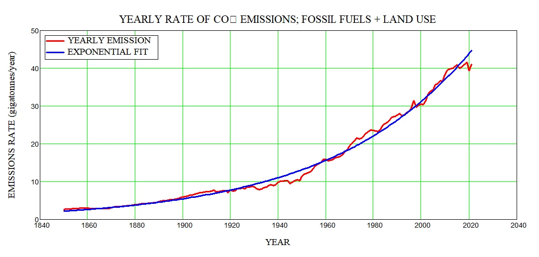

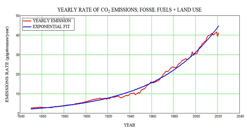

Strange graph label behavior
A few days ago, I was able to use the Unicode character map to insert a subscript into a graph label.  I was surprised I could do that, but it worked as noted in the attached png file.  Today, when I opened the same Mathcad 15 file, the subscript was lost and a blank box appeared where it should be.  See the attached images.  This is the ...2.png file.
Does anyone have an explanation for this?

I was only able to show you the original where it worked because I saved the graph with the Windows snip and sketch tool before the change.  I can no longer get the Times New Roman subscripts to work in Mathcad 15 labels.  The only thing that might have changed is I allowed a Windows 10 update in between the two cases.
