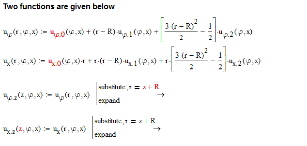

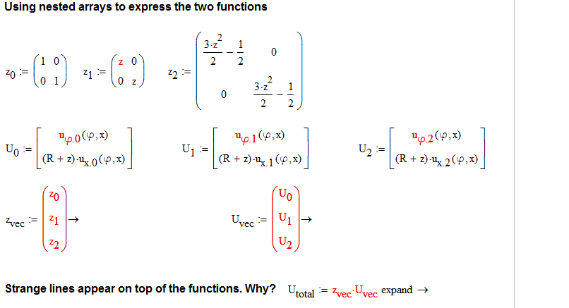

I have encountered a very strange problem in Mathcad 15. While using nested arrays to express two functions, the results appeared with having a line on top of the functions. This line does not seem to be mentioned anywhere in the manual and is interfering with calculations of derivatives.
There is of course a workaround by using the substitute function - transforming the functions with the line on top to ones without the line. The problem is, my calculations in general will contain huge amount of sub-functions and their mixed partial derivatives, so fixing the problem manually is very burdensome and inelegant.

The problem must be caused by the fact that I am multiplying functions instead of variables
Either this or is has to do with the fact that the elements are matrices themselves. I am not sure.
But an easy solution could be to transpose the first vector and that way use normal matrix multiplication instead of vector dot product:

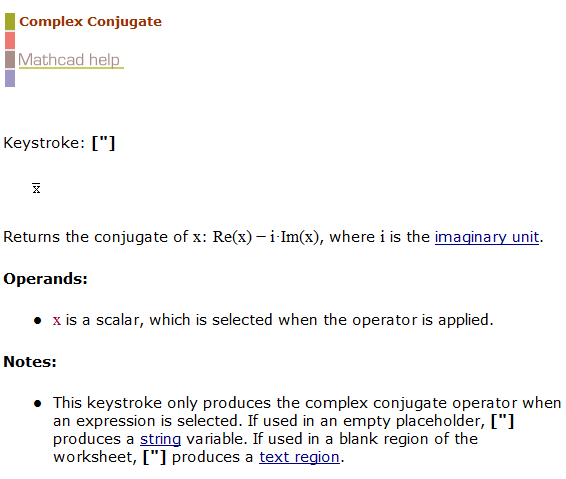

You've hit the quote key instead of the colon.  The result  produces the overbar

Mathcad correctly conforms to the mathematical definition of the dot product
-> Dot product - Wikipedia
and unless told otherwise it defaults to complex numbers
And - no, you can't use the conjugate operator on the LHS of an assignment.

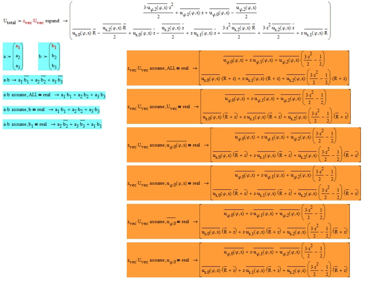

Hello Werner,
You are right. Mathcad is doing everything accordingly to mathematical definition of the dot product.
Taking the real part is the solution that is seek. I have checked the "assume, ALL = real" on my problem and unfortunately it does not work. The problem must be caused by the fact that I am multiplying functions instead of variables (I have z*u(fi,x) instead of a1*b1 which works).
I have attached a snapshot showing all possible combinations with "assume, , = real" which do not work.
